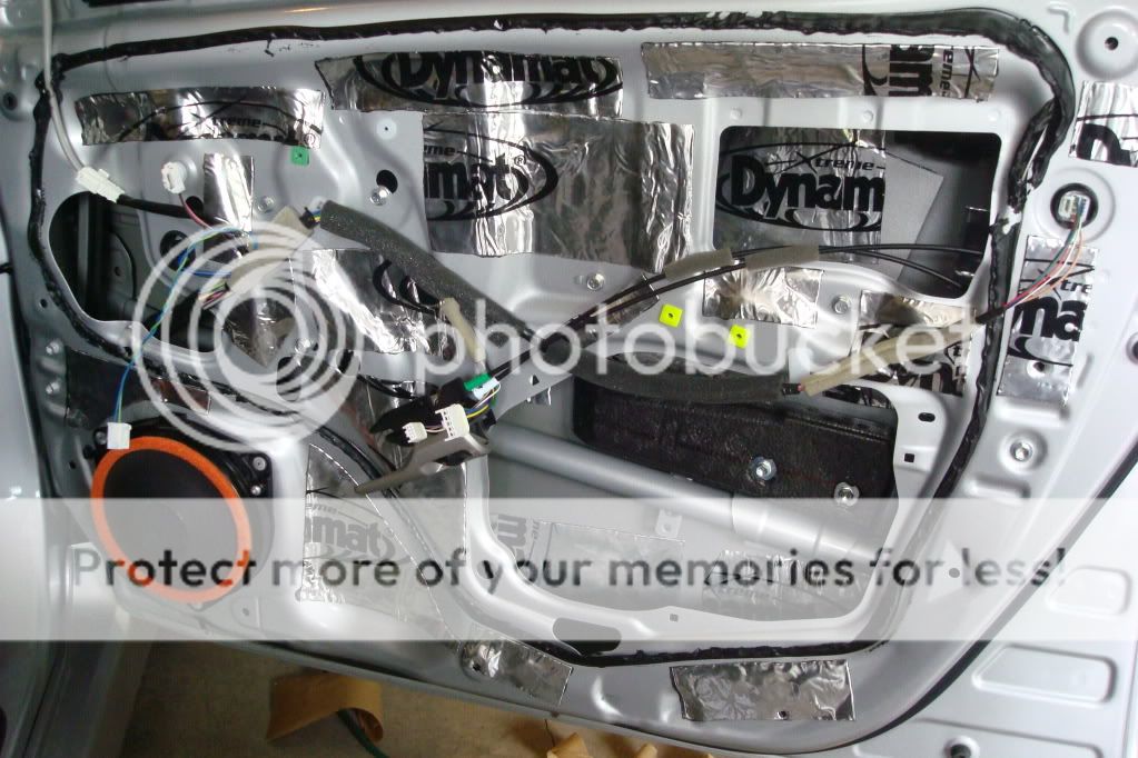

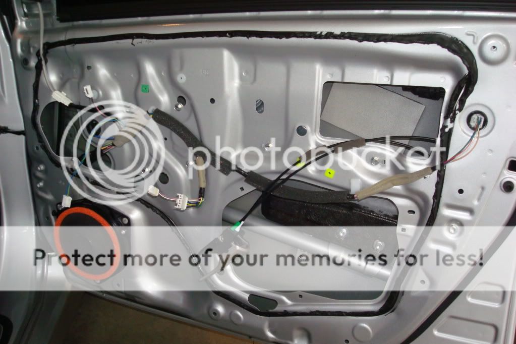

    I bought a 36 sq/ft box of Dynamat Extreme from Amazon for $95 on sale, an excellent price to be sure. :D I've used Dynamat on many cars with excellent results. The trick is that you don't have to cover every part. Smaller pieces can be used to keep the weight down with very similar results. I was told to do it like that from a Dynamat installer many years ago. here are some pics from when I did my doors on my 09 Corolla S.

    Thanks, this seems like it makes sense when you think about it. The dynamat is absorbing the sound vibration being transmitted by the vibrating door skins, and by applying it on strategic locations like the pictures, it will do what it was intented to do. Before this posting, I thought one would have to cover it so it has no holes where sound can come through... never thought of it like this before. Great info bro!

    Seems like you have to be careful what you silence. You can accentuate another noise not heard before. Lose road noise and pick up a wind whistle, doesn't seem like a good trade.

    Isn't it better to also apply insulating plastic cover on the holes?

    I've insulated the whole floor pan and hatch in my Corvette, like you said, now I hear wind noise at 160mph. lmao!
