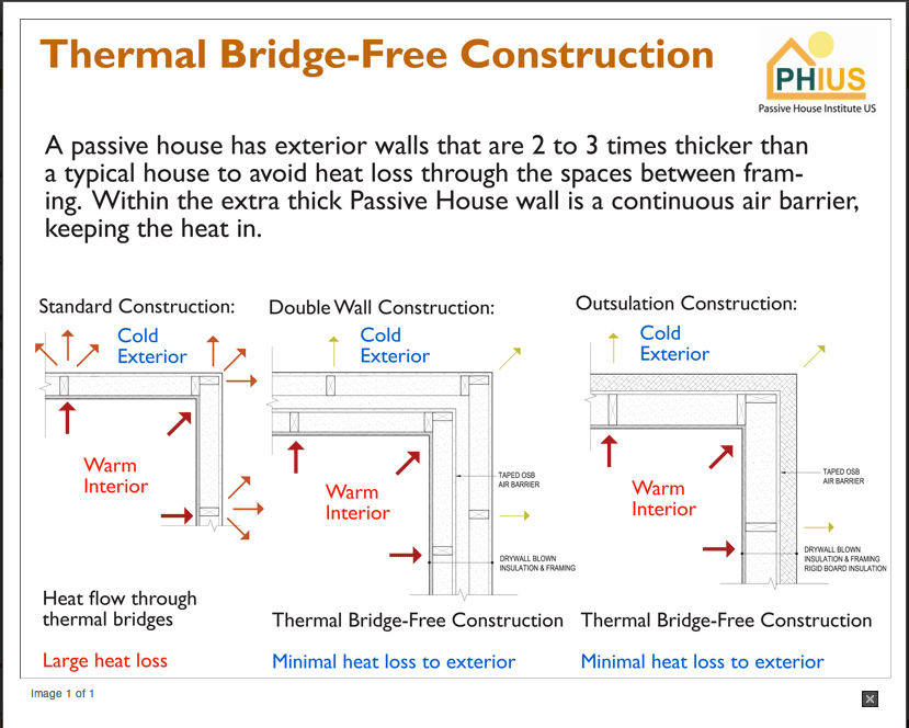

    I was having trouble grasping thermal bridge construction until I found this:
