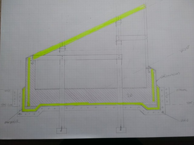

  8. 2007blueprius
    2007blueprius Member
    Dec 26, 2012
    466
    WP_20140129_001[1].jpg I think you were right, most important is not to get attached to one idea or another, I was kindof growing fond of the angled glass I liked it honestly, I drew this last night based on some of the disscussion here and other forumangled glass, and drew iut vertical instead, that alone simplifies the build a lot the third row of posts were there in the old one just to prop thet wall of glass up so I eliminated a third of the foundation work, some of the concerns that were brought up about sagging and sealing are much eliminated, I also moved the 2 ft rammed earth on the outside of the framework and gained some square footage , as for the roof I left it at 12 inch thick aprox R48 on a bad day, floor is about R24 and so are the walls, I read a bit on some of the work the sweedish have done particularily insulated shalow foundations, and drew mine like, I need to do more reading into the pasivehous came across the name briefly need to know more.
    in the end I am growing quite fond of this new drawing, maybe I'll have to tweek it some maybe more insulation in the roof, the winter sun exposure diminished a bit part because the 4 ft wall on the south side is closer to the living space but I can live with that most of you thought it was too much before even now still, I can live with it considering all the headackes it eliminates, and honestly I am not sure if heat gain in the winter will be affected at all due to the vertical angle but in the sunmer solstice sun the glass is at a much shallower angle hopefully bouncing off more light than it alows in, ( I know don't hope, rough gutt feeling for now once I decide on something we'll see about the math ) thanks to all that pitched in
