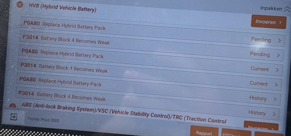

    - Do you know which charger can make the process shorter?
    - I thought as the builder of the prolong charger Jose would know very well what he is doing. Apparently not?!
    - See the attachment for the exact error code. If i’m not wrong each block contains two cells. If it says block 4 is weak then one or both of those cells are weak right?

    You could make your own charger and pump a higher current into each module. This will make the process go quicker, but you also risk damaging more modules. If you end up needing to replace more than three or four modules in a pack, you should consider buying a new pack—pay once, cry once. Unless, of course, you find it fun to take the pack out of the car multiple times, replace modules, balance the pack, and reinstall it over the course of a year.
    Your understanding is slightly off. Each block contains twelve cells. These twelve cells are arranged in two modules, with each module containing six cells.
    Yes, within block 4, it could be that one or more cells in either or both modules have failed.
