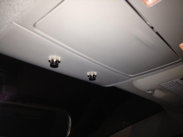

    The III I bought Tuesday didn't come with a Homelink mirror, but I was just going to add one until I read all the threads about how the auto-dimming function doesn't work that well in the gen III models. I really couldn't care less about having the auto-dimming mirror, and I tinted the windows today, so it probably wouldn't be huge deal anyway. What I DID want was to be able to program my gate and garage doors into the car and not have to have remotes clipped anywhere. As I was looking around, I noticed a bare plastic panel just in front of the sunglasses holder.
    I went to ACE and bought some momentary switches and took them apart, so all I had left was the button that physically moved in and out (spring loaded to always be out except when you press it). I used velcro to stick my gate remote and garage door opener against the roof where I removed the plastic panel, and then drilled holes to mount the buttons. Basically, all that happens is that I push the button, and that, in turn, pushes the button on the remote. It's very simple, and now that I know it works, I might look for some nicer looking buttons at some point. Because of spacing up there, I couldn't fit buttons for the other garage doors, but I got the gate and the garage where the Prius will park taken care of anyway.
    Just thought I'd share in case anyone was interested in not having remotes laying around, but didn't want to add the whole Homelink mirror.

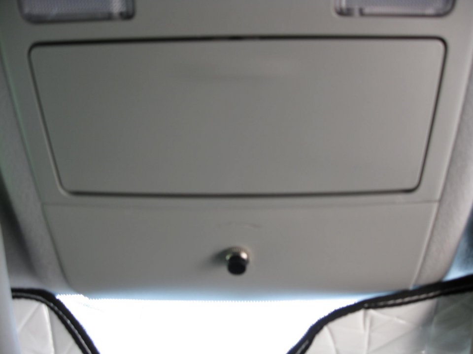

    Thank for the great idea. I did mine the same day as your original post.

    Nice! Glad I could help. It looks like you even got the exact same button. lol

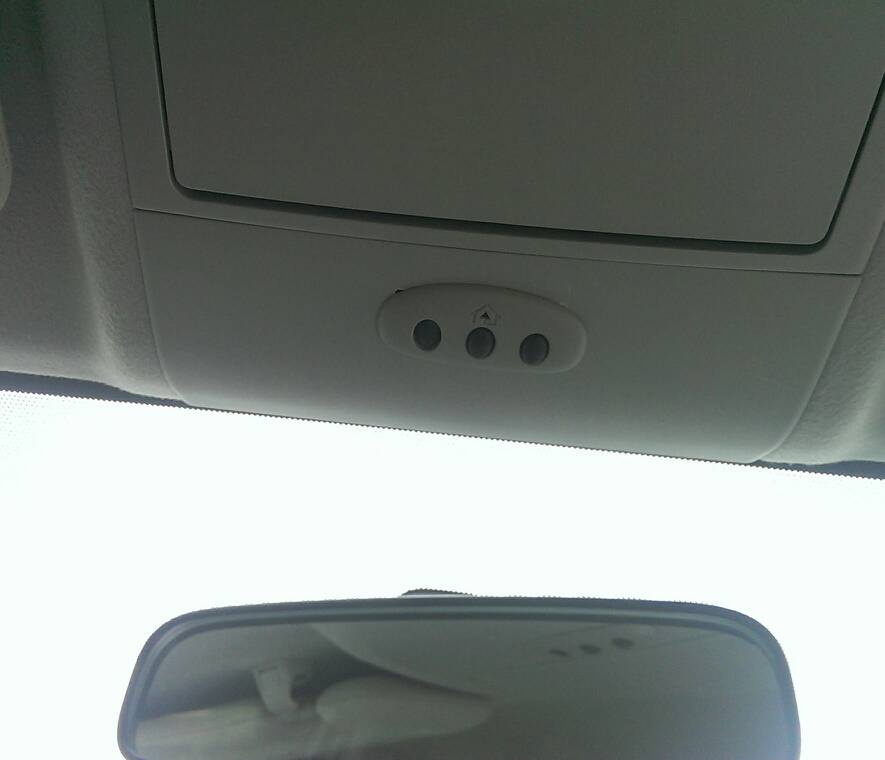

    Had a chance to snap a pic of my mod. I got this idea from a local member on the board.

    I wanted a homelink option but didn't care for the dimming mirrors. I met up with a local member to sell my extra grill. We were showing our mods off and his homelink mod caught my eye. Basically he took a visor homelink unit and retrofitted it in that empty space. Since I didn't care for the dimming function, this unit is so much cheaper than the gentex mirrors. $20 vs $150. The DIY took me about 2 hrs because I was using a razor. Could have taken out the dremel and finished much much quicker.

    I got the module off eBay. It is about 20 and just needs a (+) and (-). I got the constant 12v from the dome light harness about 3inches away. The dome light harness should have its own fuse. Search for 'homelink visor' on eBay it should come up.

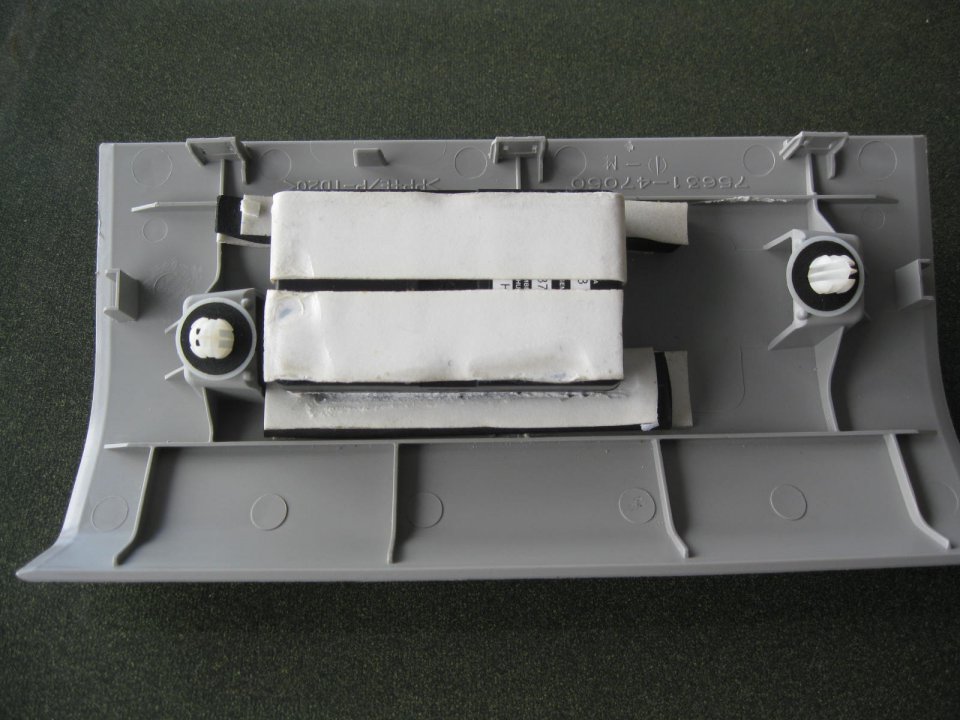

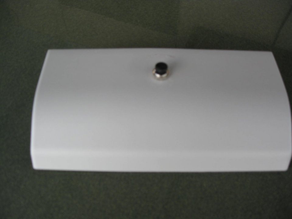

    genetiix, your install looks much nicer than mine! You did a great job! I had to install mine a bit off center to avoid having to cut into the plastic underneath. Were you able to install the homelink unit without breaking it apart, like I did, or you were able to fit it in one piece?

    I broke it apart, however that cause more harm. Because how my module is (single circuit board) , the buttons need to physically push onto the circuit board to work. I then had to tape it back when assembling in order for the little rubber buttons to reach. Ill take out the hot glue gun one day and make it permanent.
    I remember seeing yours with 2 circuit boards, and that install would have been much cleaner.

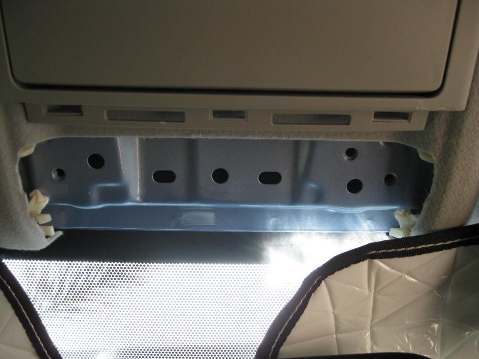

    very nice... just wonder how to remove the panel? thanks

    The cover is held in place with two plastic retainers. Grab it from the windshield side. It snaps right off. Look at the pictures in post #6 above.
