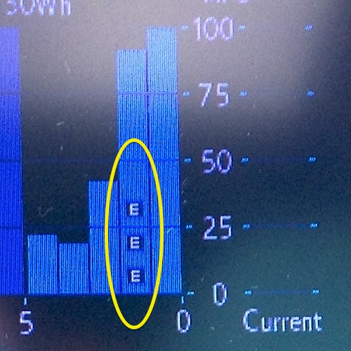

  13. Well I set a new personal best today, I was able to get onto the highway and I was able to hold an ECO score of 100 for 51 seconds.
    Then later as I was about to get off the highway, I saw all these Es on my touchscreen navigation thingy... I got 3 of them which I've never seen happen before
