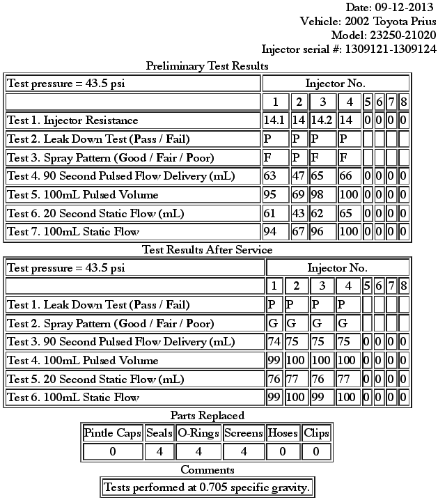

  18. ChapmanF
    28,704
    19,006
    It looks like a smaller difference that was seen for injector #2 in astrolink's set back in 2013, but, yeah:
    The problem with astrolink's #2 can be seen consistently in both pulsed and both static flow tests. And astrolink's car was running like cr‌ @‌ p before the restoration. The car has a limited ability to adjust for flow variations between injectors, because there's only one A/F sensor. (Somebody recently posted that late models really do have some ability to time the A/F sensor signals with the camshaft and know which cylinder's getting what!)
