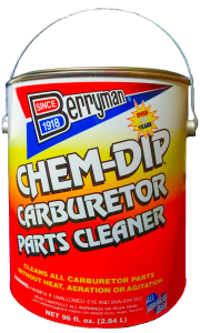

  9. strategy400
    strategy400 New Member
    Feb 21, 2020
    25
    Victorville, CA.
    2015 Prius c
    Can you soak the parts in chem dip? That would get them spotless.
    pjksr02, Bay Stater and ASRDogman like this.
  10. Bay Stater
    Bay Stater Senior Member
    Mar 3, 2016
    534
    771
    Central Mass
    Don't know what that will do to the non metallic parts. Best to use brake cleaner and/or Oxi clean.

    Yeah same here. Most everything except the EGR cooler can be done with just brake cleaner and brushes/rags. I try to minimize use of that stuff, use less spray and more scrubbing. It's nasty stuff: the chlorinated is more carcinogenic, the non-chlorinated more flammable.
    With the cooler, going straight to strong/hot Oxi-Clean solution soaks, it's less toxic and more effective: win-win. Oxi-Clean (water soluble, powdered laundry additive, moderately basic) is very benign.
    Be careful with the EGR valve too: it has electronics under the black-plastic cap, so don't spray anything directly at it's seam. I wouldn't bother with disassembly either; it's screws are tough, and the insides a little tricky/delicate.
