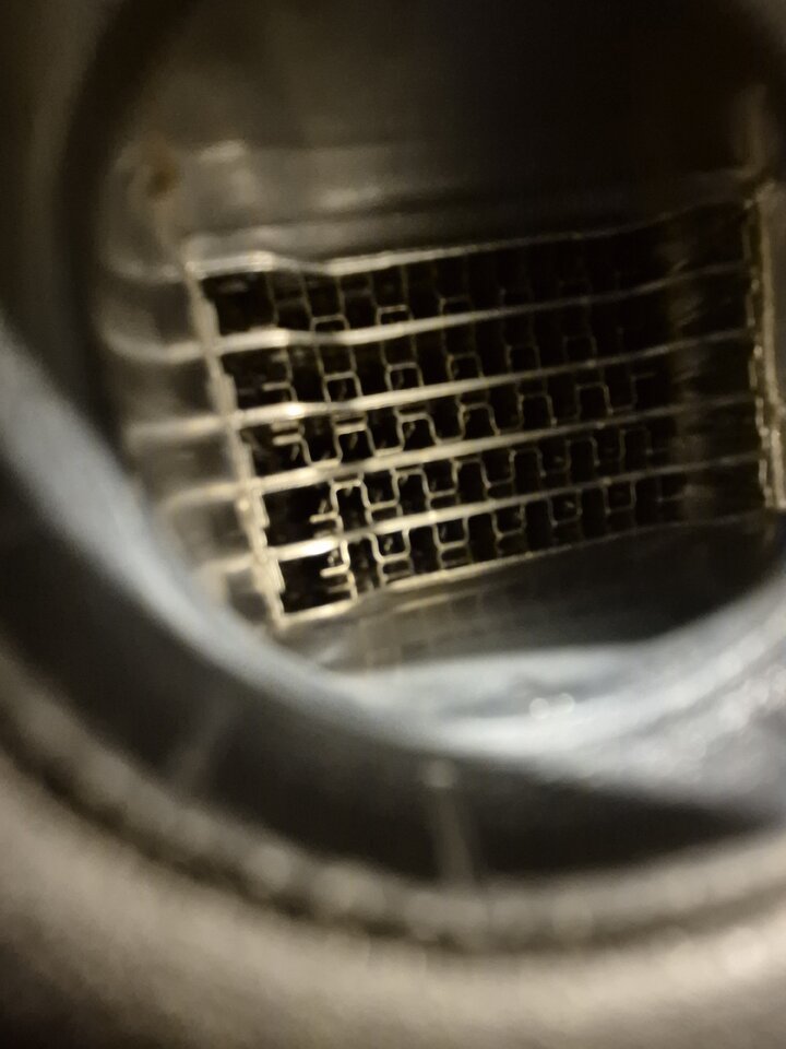

    Well, keeping my threads separated between intake manifold and EGR cooler. Here is the EGR cooler after two days soaking in OxyClean & Purple Power. MANY times with the pressure washer both through the inlet and outlet sides. Then half a can of Easy-Off oven cleaner.
    I would say I spent 3 minutes per pressure washer routine. Probably did that for a combined time of an hour !
    LOT's of pressure washer cleaning (almost always would be clean and as I rotated around the tube..would then hit an obstruction and then BAM..black and chunks).
