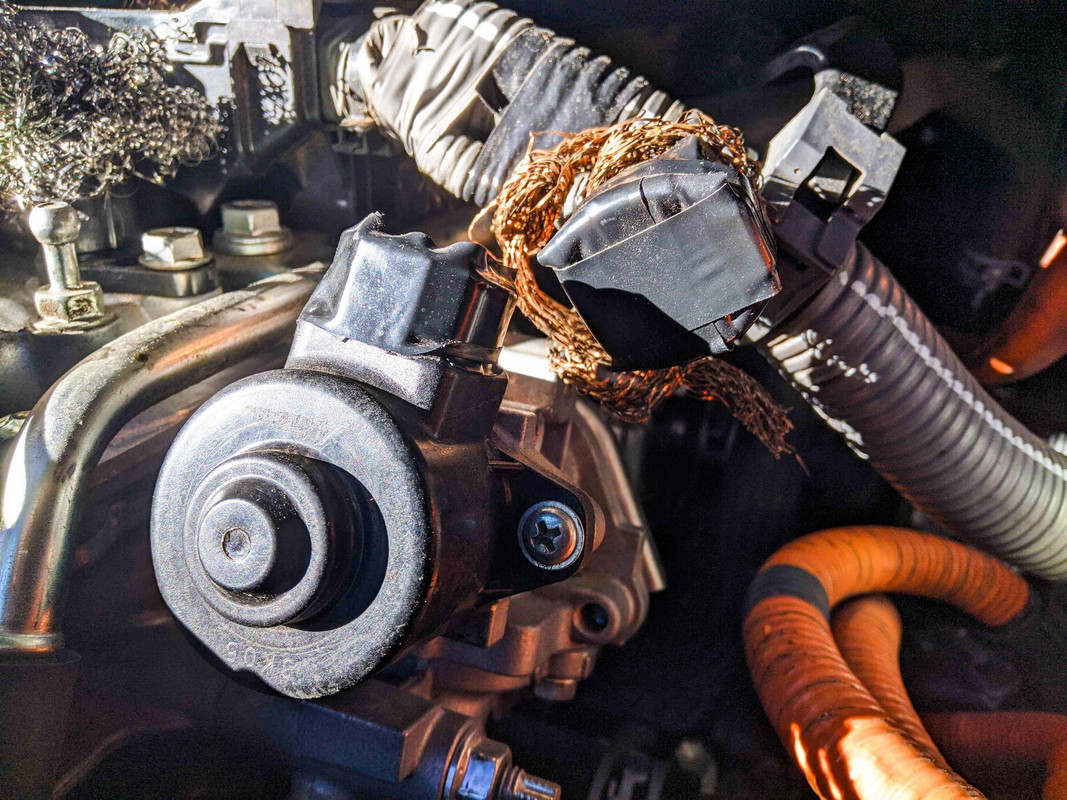

  5. StarCaller
    StarCaller Senior Member
    Feb 15, 2014
    1,284
    733
    Cedar Crest, NM, USA
    (The copper & steel wire mesh is to keep rodents away / )
    johnHRP, MPGS-LOL and Bill Norton like this.
  6. Bill Norton
    Bill Norton Senior Member
    Dec 15, 2012
    2,244
    754
    MONW, Ks.
    2019 Prius
    L Eco
    Lovely job.
    I have a cat. He's on a mission to rid the neighborhood of rodents, lizards, cicadas, and unfortunately birds. I wish cats were trainable...:unsure:
