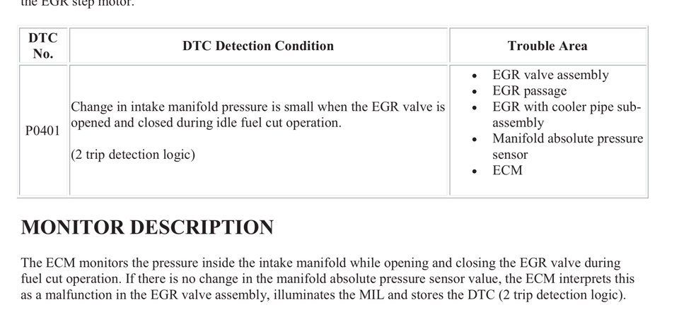

    This has me contemplating an EGR Delete. There are two approaches: Removing the electric connector, and installing a plate to block the EGR gases before it hits the valve. I like the second approach because it is stealthy and it will cause no CEL.
    But the problem I foresee is that when the computer opens the valve, it will think the Fuel/Air ratio is different than it really is.
  12. rjparker
    rjparker Tu Humilde Sirviente
    Jun 6, 2008
    10,988
    6,889
    Texas Hill Country
    You will get a code after the system tests the egr flow and measures intake pressure.
    However the code is not as quick as an electrical disconnect (P0403).
