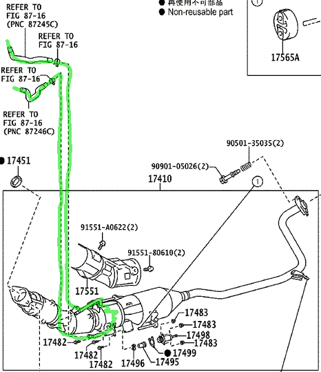

    The EHRS pipes engine coolant through a heat exchanger built into the exhaust pipe, controlled by a wax thermostat opening and closing a valve, as shown in the diagram above and the one below.
    If you're prepared to 'argue' how the EGR is somehow necessary for that to work, here's your chance.
