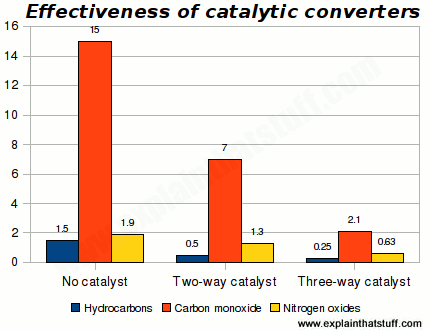

    Increasing mileage reduces emissions too.
    Common misconception. EGR is not meant to burn unburnt combustion gasses (CO & HC). That's the job of the catalytic converter:
    EGR was originally designed to lower combustion temperatures to reduce NOx emissions by introducing what is nearly inert gas into the combustion chamber. Any unburnt hydrocarbons are just a bonus. See How Exhaust Gas Recirculation (EGR) system works
