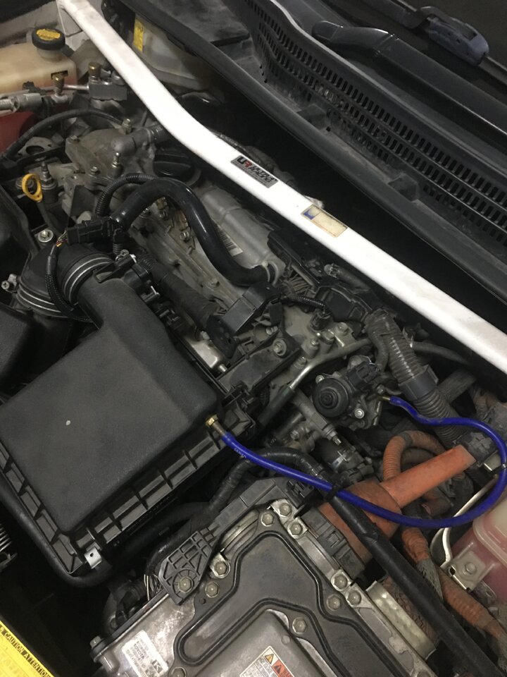

    thailanf
    i m not sure bout emission because i m not in us but i had done it more than 5 yr ago. for performance it should be used with airflow wire hack to rich up fuel but it work without too. u do need to drill the egr to connect fresh air line to egr or check engine light will light up. no ecu reprogram needed.

    i trick airflow wire with resister wire to think air temp is lower than actual. mine drove everyday but short distance it only 99000km but there r other that did the samething with over 100000 km. i did mine when it was 50000km

    i dont remeber why would engine couldnt run without egr? and i dont think without egr would create enough heat to damage engine

    i dont think egr will cause engine overheat since there r cooling system and as far as i understand without egr ecu still read af from o2 sensor and adjust fuel to not running lean. i mention that without airflow wire hack there is no knock occurr which should indicate that it s not too lean but i use airflow wire hack to rich up fuel anyway.
    i havent had any cel at all. only hybrid battery cel when once which is its time to replace battery never have any engine cel. also no coolant lost ever happen too.
    ps: i m not talking about emission which i think what i did will absolutely effected else safety factor in ecu will do the job without problem
