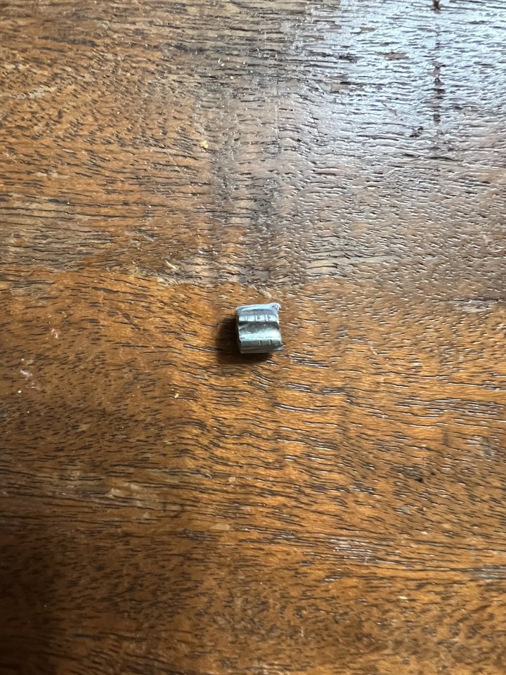

    I need some help/advice on what to do in my situation. I am currently working on removing the EGR cooler, and was able to get the top bolt and stud off the rear connection (to the exhaust manifold pipe), but the lower one I'm in some serious poop. The bolt came off fine, but when trying to remove the stud with an E8 socket, the tip sheared off and now I have no way to remove that stud. Am I completely screwed here? Any help would be appreciated!
    Attached is the part that sheared off, for reference.
    Thank you!

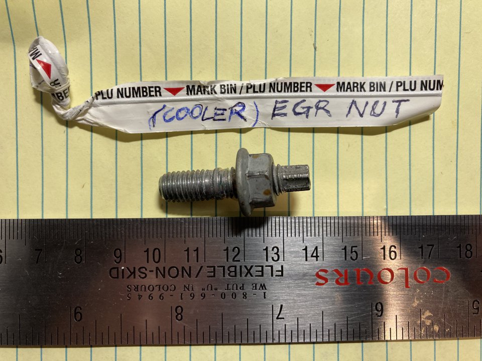

    Not sure, but that one MIGHT be same length as one you broke. For ref, here’s the one I took off (a long time back) from ours:
    I suspect it’s shorter, but worth checking. If it’s not a match for the broken one dealership can get one in for you.
    Another stud that may be identical to the broken rear one, is that upper/front one, at the valve: check its length against the rear cooler stud you did manage to remove. It can be left off, at least temporarily, swapped to the rear location, which is much more critical. I’ve got a hunch that one IS the same length.

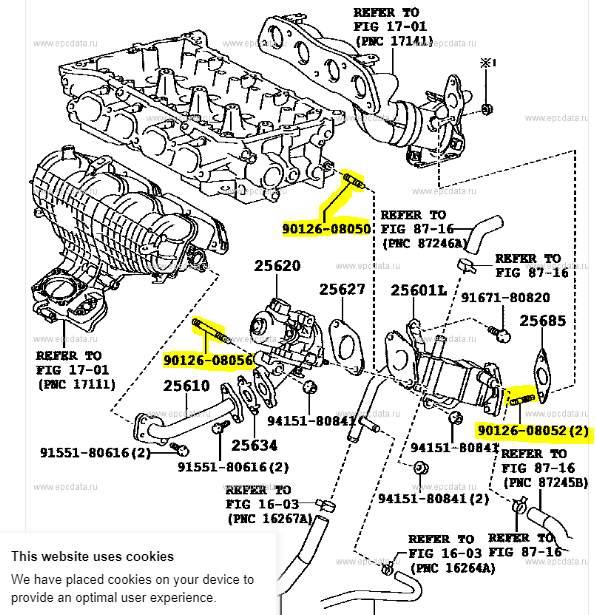

    Judging by the part no's on this page:
    https://www.amayama.com/en/catalogs/toyota/prius/3-hatchback-right-xw30-2009-2830/engine-fuel-system-and-tools-1/exhaust-gas-recirculation-system-52
    The two rear studs on the cooler are unique, not swappable with either the stud at the valve, or the the stud at the lower cooler bracket. Here's a screen grab from above link:
    But yeah, if you can get that lower stud backed out (901260-0856), then you WILL be able to pull the EGR valve/coolder assembly out, with the broken rearmost stud still installed.
