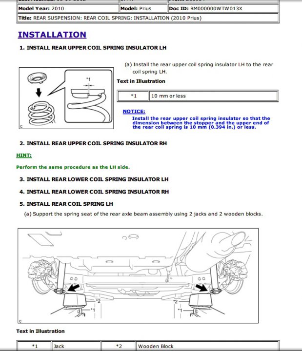

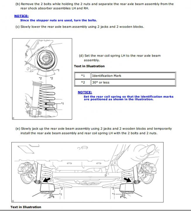

    According to the service manual, the rear cups/insulators need to be installed in a specific orientation. I did notice that the top of it did have markings on one half and the other half had none. See RS2.jpg for the orientation info.

  13. BigPete
    BigPete Member
    Jun 3, 2012
    149
    56
    Plymouth, UK
    Thanks!
    Difficult to see what orientation the springs are supposed to end at if you don't have ones with markings on. Is the end of the spring at the top supposed to end on the back side of the car or front?
    I fitted mine and don't take any notice, but unsure if it even makes any difference as long as you got the spring cups top and bottom in correct place on spring?

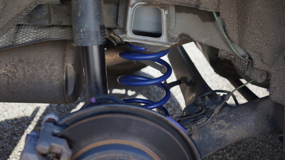

  15. BigPete
    BigPete Member
    Jun 3, 2012
    149
    56
    Plymouth, UK
    Ideal, I know for the drivers side, yr passenger side I have it so it end on the side of the car as the photo, but on the passenger side it is on the inside I the car.
    Wasn't sure whether it effected height or anything, as I do look at the car sometimes and think there is more gap on one side of the rear than the other. image.jpg
  16. peterjmc
    Dec 5, 2010
    917
    189
    Clarksburg, MD
    Ooops I think I mis-read your post questioning the orientation of the spring. I'm not sure which way the end of the spring should end. I just know that the ribs/markings need to be facing towards the outside of the car.
    There is a common complaint where the rear drivers side is sometimes lower by an inch in comparison to the passenger rear, even on a flat. I've experienced this before but when I park again it's perfectly normal. Not really sure what causes it.
  17. BigPete
    BigPete Member
    Jun 3, 2012
    149
    56
    Plymouth, UK
    Wondering if anything to do with the foot brake.
    I'm guessing by looking at those attachments if you stand at the rear of the car the spring top should end facing you? Anyone with lowering springs can you have a look then ill go and twist mine accordingly.

  19. Totmacher
    Totmacher Honey Badger don't give a carp
    Oct 2, 2011
    301
    110
    Mission Viejo, CA
    The manual is referencing aligning the spring to the top rubber bushing. Outside that the orientation of the now combined spring/bushing to the rear beam is pretty much irrelevant.
