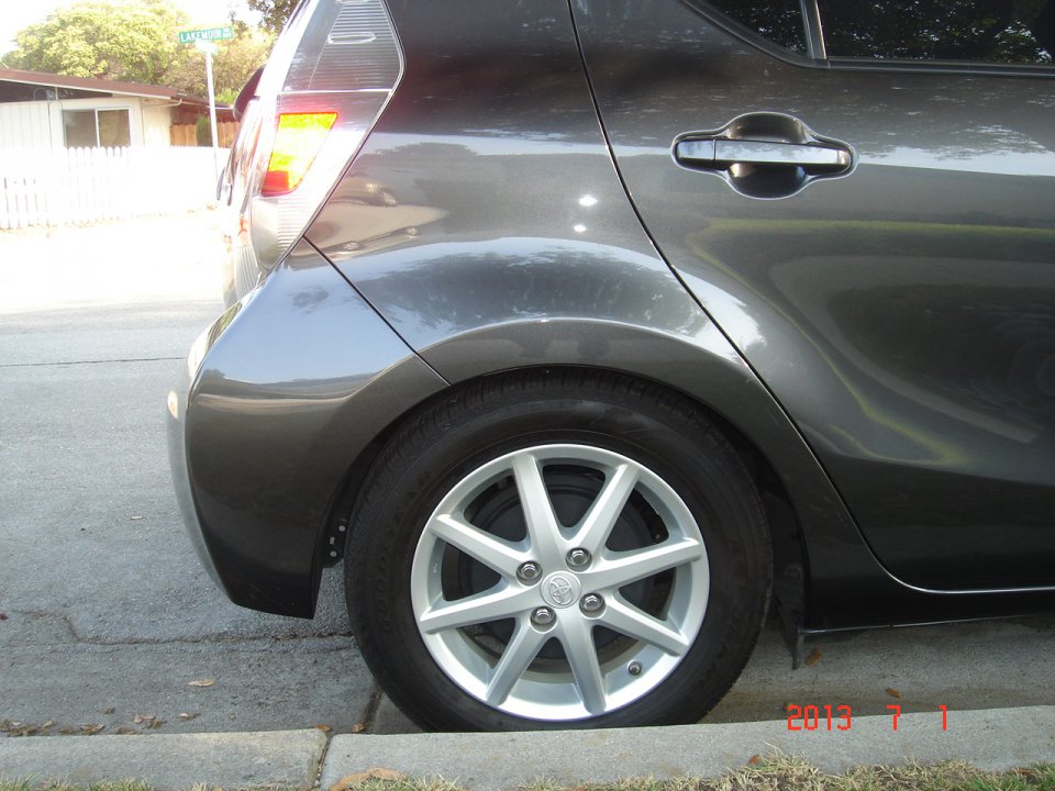

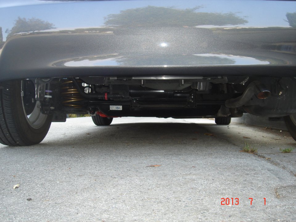

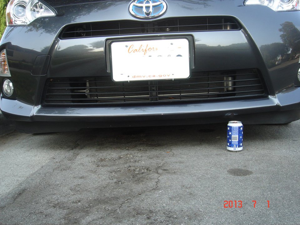

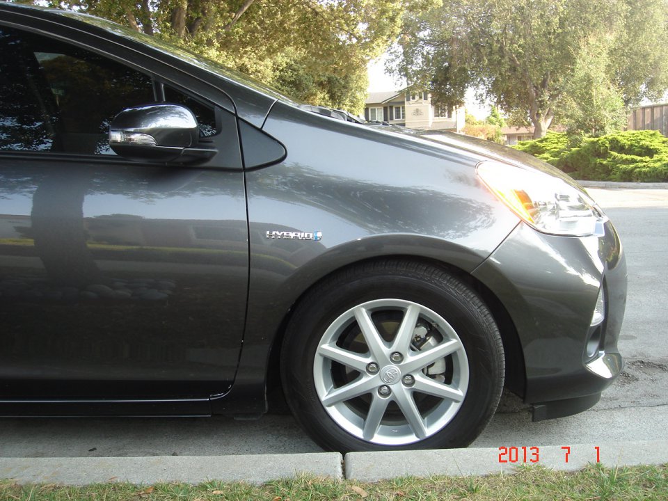

    Edit - Tein H Tech's installed:
    Scratched the initial post. Since Eibach's didn't fit, the ones I ordered were for the regular Prius, I went with the Tein H Techs. Advertised 1.2 in the back and 1.4 in the front.
    I had them installed on Friday and overall they are comfortable. A little softer than I expected which reminds me of the good 'ol days riding in my dad's Cadi and Lincoln; smooth and comfortable. Would like some more control over dampening, but for springs on stock shocks, not bad at all. Anything lower than this would be too low to cover normal roadways and parking lots. As is I have no issues clearing speed bumps, entering driveways, etc. Of course some of that is previous driving experience with lowered cars.
    The setupfor now:
    • Springs - Tein H Tech
    • Shocks - Stock (approximately 12k on them now)
    • Wheels - 15" Toyota alloys
    Rear Under Carriage: DSC03476.JPG
    Front (Car is on an incline):
    Front Wheel:
    Rear Wheel:

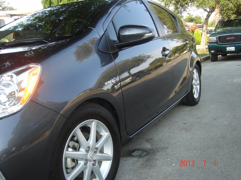

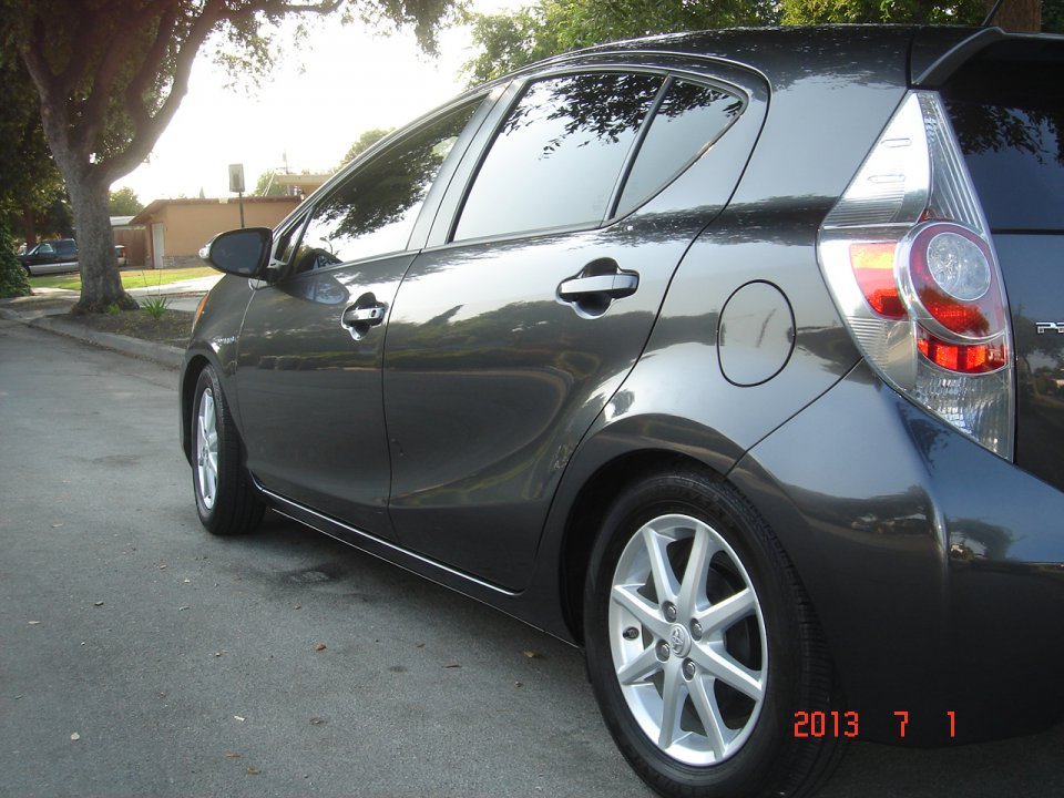

    Angel Shots:
