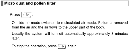

    The Gen 3 air cleaner ("micro dust and pollen filter") button simply relied on the ordinary pleated cabin filter behind the glove box. Pressing the button would make the system shift from fresh to recirculated air and run the blower on high for three minutes, then go back to whatever the previous settings were. So its function was just to make sure a lot of the air inside the cabin would get passed through the pleated filter quickly.

    It is a nice feature, even though it doesn't rely on any kind of electrostatic filter, just the regular pleated filter behind the glove box.

    right, but it seals out more of the toxic air. what will an electrostatic filter might filter better, but the same amount of outside air will be coming through it.
