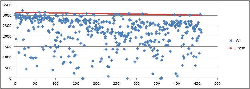

    What I see from some others (including myself) is that initially the maximal charging sessions use just above 3000 Wh from the net and due to degradation this is estimated to decrease by about 1.5% to 2.5% per year (when per year between 2000 and 3000 EV miles are made). Below you see graphs of two different cases of which the first one is from myself.
    If initially your wife's maximal charges took 2740 and now 2580, then this would be a degradation of about 6% up till now, which seems in line with the other estimates, as in your wife's case the number of EV miles per year and the number of charging sessions (including the mountain descent charging sessions twice a day) is higher. Also the outdoor temperatures will play a role. Probably later this summer still higher numbers will be reached, and using these numbers the estimated 6% can become a bit lower.
    But I wonder why this initial number 2740 is 9% lower than the 3000 seen in other cases.
