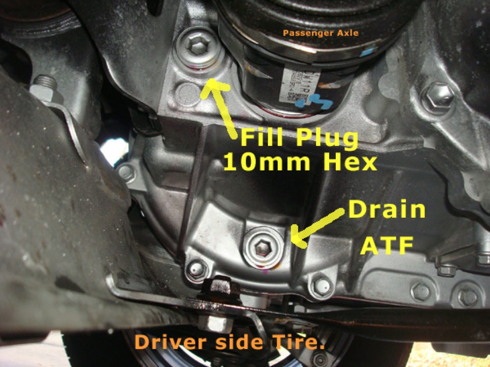

    The transaxle is cooled two ways, via coolant from the inverter coolant loop and via ATF bathing the two M/G directly. There is a small ATF oil pump that runs whenever the engine is running. (the left side with the Black oil pan and oil filter is the engine, the right side with the coolant and Automatic Transmission Fluid plugs labeled is the transaxle. The silver lump to the far left is the A/C compressor. Toward the back on each side are the axles to the front wheels. On a Gen 3, the plugs marked in green are by those axles.
    Gen 3 transaxle plugs
