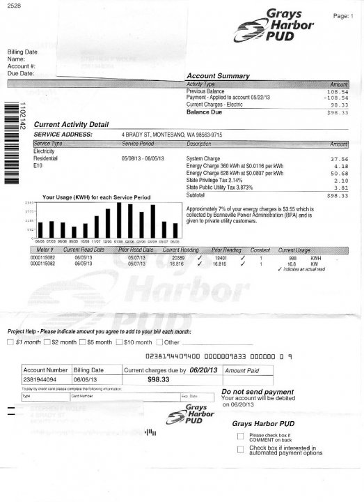

    Here is a copy of my most recent bill. Bare in mind that this is low heating season and later this summer I might use a little AC. Check out the other fees.
    Even the winter heating goes up to about $200/mo and that is with half my heat from wood pellet stove and half from heat pump.
    Yes, I'm lucky to be on this PacNW power grid but still wish I had natural gas and the pipe line is only a mile away. The price of electric keeps all the community from considering natural gas as an alternative.
    Steve

    Well, between the hefty fixed charge, and then the low (8 cents a kWh) charge for high consumption, conservation is certainly not encouraged.
    Btw Steve, the best way to hide private data on a scanned document is to open the scan in a graphics program (any will do) and 'paint' over the private text.

    The details show that the $0.0016/kWh for the low tier isn't as nice as it first appears, thanks to the $37.56/month base service fee. Combine them, with the taxes, and that first tier ends up costing at least $0.123/kwh if the whole tier is used. And more per-kwh if fewer kWh are consumed.
    Also note that the service address is still displayed. Consider editing that out before the edit deadline strikes.
