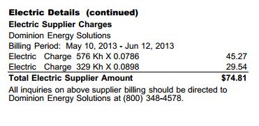

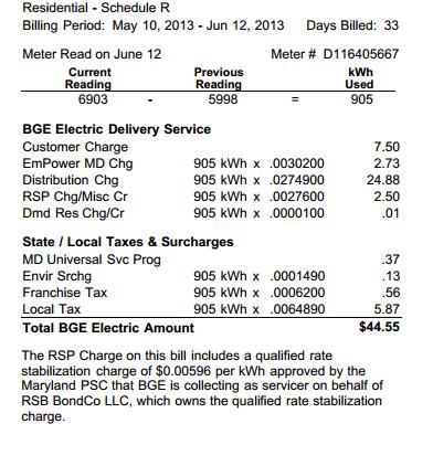

    Right you are -- other than $7.87 fixed charges, the other charges are per kWh.
    It looks like you have two tiers that apply to your bill -- the first 576 kWh, and then a higher charge afterwards.
    Since a PiP would add on from the top, your marginal kWh rate is:
    Code:
    0.0030200 +
    0.0274900 +
    0.0027600 +
    0.0000100 +
    0.0001490 +
    0.0006200 +
    0.0064890 +
    0.0898000
    0.130338
    ~ 13 cents a kWh

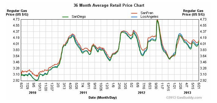

    I wasn't using NM -- we would be horrified at $3.63 ;)
    Hard to eyeball this chart -- perhaps 3.8 since 2011 ?
    If that is the case, add on 5% to your savings -- you are closing in on $7 a month ;)
