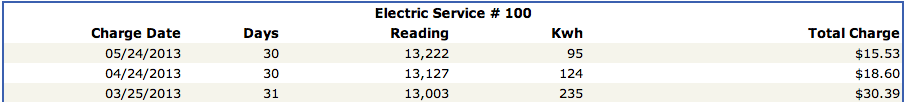

    My first full month electric bill since I started this thread:
    Happy to say I broke the emotional < 100 kwh a month barrier. Somewhat like a 70 mpg tank with the Prius ;)
    I imagine this level of consumption will not be difficult to maintain for the next 6 months, but winter will be a challenge.
    fuzzy1 and xs650 like this.
