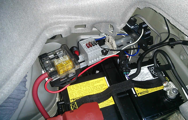

  7. ChapmanF
    28,704
    19,006
    It's not hard to build an aux-power distribution thingy using a gizmo like the InPower VCM-06 to turn it on and off. You don't need to find specific switched circuits to tap into; the VCM just recognizes the voltage difference between when the car is READY and when it isn't.
    That was the Gen 3 reimplementation of the original Gen 1 thingy.
    -Chap

  8. PriusCamper
    PriusCamper Senior Member
    Mar 3, 2012
    13,446
    5,428
    Pacific Northwest, USA
    Wow... That's a pretty extreme rig... Just looked at 'em on Ebay... Back in my Campervan building and car stereo installing years in late 80's thru early 90's I would of never imagined something so fancy. You could do alot of pushing the limits of what a Prius is capable of with gear like that.

  11. ChapmanF
    28,704
    19,006
    All comes down to your application. Each of the existing power outlets is rated ten amps. If you want to power some things that won't ever need more than ten amps together (either they add up to less than ten, or they're individually less and you know you'll never use them together, or so on), an extension cord sharing one car outlet is the simplest solution and completely does the trick.
    It's only if you want to run things that draw more current than that, or just too many things, that an extra power distribution gizmo becomes useful.
    -Chap
