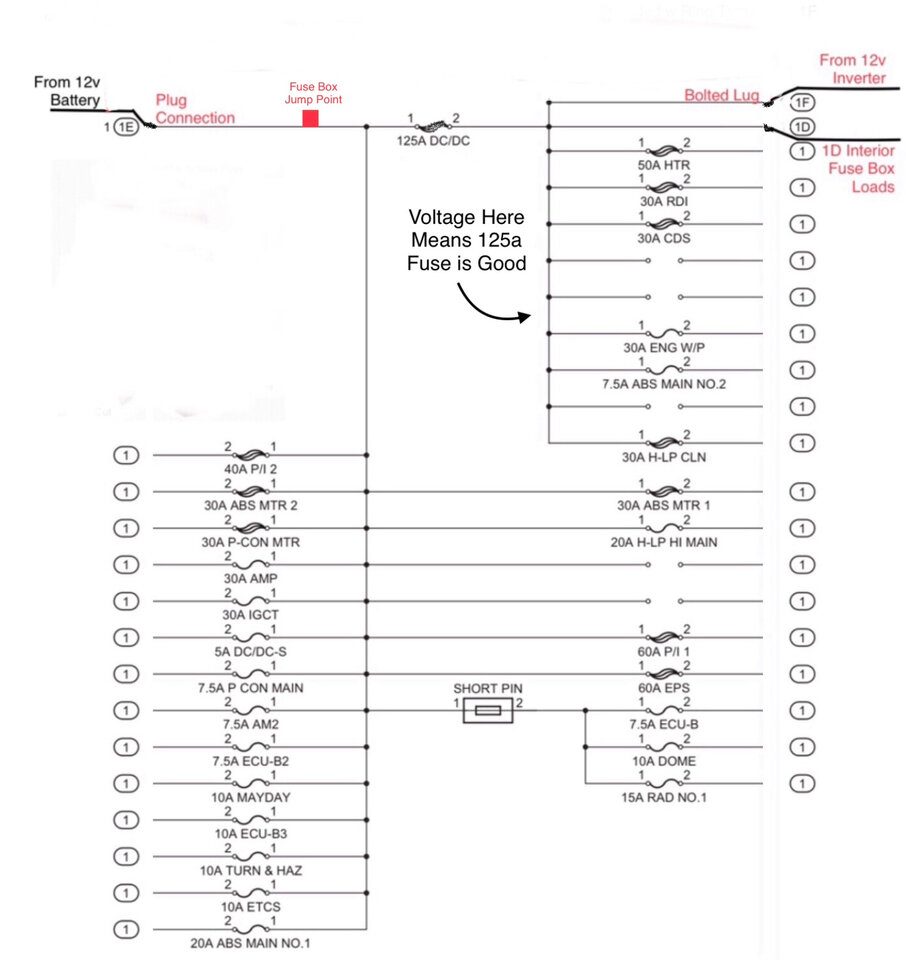

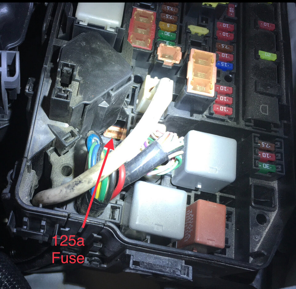

    I would certainly check the hidden 125 amp fuse first.
    BiomedO1 likes this.

    ^Yep, if the inverter pump shorted or any large current draw could pop that 125A fuse.

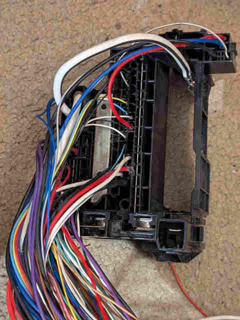

    Anybody got one of these fuse boxes out laying on the ground FLip over take back cover off if it has one . Pictures ?
  8. ChapmanF
    28,747
    19,050
    Spend enough time disassembling and removing the modules that are removable and you kind of get to this:
    (out of the frame are four other relay-socket modules that come apart from this big one but still are direct-wired parts of the harness).
    It's looking like if you really wanted to replace a fusebox and not the whole harness assembly you wouldn't have to make more than 70 splices maybe. Doesn't sound like a job I'd want (and I wouldn't be sure 70 splices would fit back in the enclosure).
    Alternatively, it's clear that at the factory they crimp the fuse terminals onto those wires and click them into the right positions here. If you feel your terminal-extraction-fu is strong, you could consider extracting them all and clicking them into the right positions of another fusebox. But I guess if corrosion of the original terminals was the problem, that wouldn't be such a promising idea.
