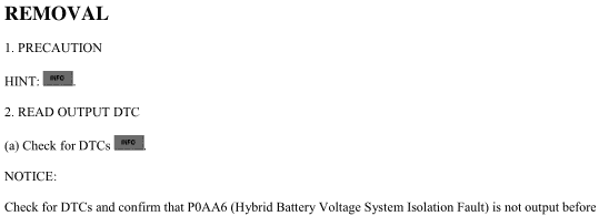

    He's kinda not wrong, as long as there is no P0AA6 isolation fault code being reported for the battery. (A person following best practice would still wear PPE all the same.)
    If there is a P0AA6, do ya feel lucky? Well, do ya?
    I've never been in the same room with a pair of 8000V-rated gloves, but I bet they're uncomfortable and limit dexterity. 1000V (class 0) should be plenty for a gen 3. (You should even be able to get away with class 00 as long as you're not inside the inverter or MGs during operation.)
