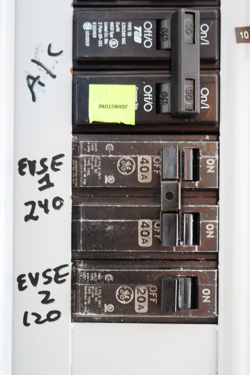

    Just to be sure that you aren't misinterpreting that I might flip the circuit breaker while my car is plugged in -- I don't do that. I will flip the breaker to off if I think we're going to have severe thunderstorms, of if I won't be using the L2 EVSE for extended periods like a vacation (the EVSE is located outside and not in a garage).
    I do also wonder, however, if the EVSE, when the car is not attached, might be drawing enough of a current that might cost me something. Or, might such a constant low current keep the humidity at moderate levels and help protect it from corrosion?

    Relevant portions of the National Electrical Code:
    NEC 2011
    404.11 Circuit Breakers as Switches. A hand-operable circuit breaker equipped with a lever or handle, or a power-operated circuit breaker capable of being opened by hand in the event of a power failure, shall be permitted to serve as a switch if it has the required number of poles.
    Informational Note: See the provisions contained in 240.81 and 240.83.
    So according to the NEC, circuit breakers can be used as switches with some provisions.
    240.81 Indicating. Circuit breakers shall clearly indicate whether they are in the open “off” or closed “on” position. Where circuit breaker handles are operated vertically rather than rotationally or horizontally, the “up” position of the handle shall be the “on” position.
    240.83 Marking. (D) Used as Switches. Circuit breakers used as switches in 120-volt and 277-volt fluorescent lighting circuits shall be listed and shall be marked SWD or HID. Circuit breakers used as switches in high-intensity discharge lighting circuits shall be listed and shall be marked as HID.
    If the circuit breaker clearly indicates the "on" and "off" position ("on" being up in vertically oriented situations), and the breaker is labeled "SWD" and/or "HID". Then the circuit breaker can be used as a switch, as far as NEC is concerned.

    Ok, I’ve finall located my Kill-A-Watt meter and plugged the supplied EVSE through it. Without a load, these are my readings.
    Watt = 0.5
    Amp = 0.02
    Volt = 3.0
    kWh = 0.11
    PF = 0.17 (don’t recall what PF stands for)
