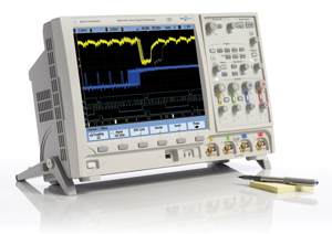

    [Images below are shamefully stolen from across the googly-webs]
    I have an Agilent 54624A which I use all the time. I pretty much learned on this scope, so I am very familiar with it. The memory depth is awesome, even if it is only 100MHz. Downsides are that it is a monochrome screen, so all the traces look the same. I don't find it a big deal, but some people really like the coloured waveforms. The other slightly annoying thing is that when scrolling the trigger time mark, it moves in relation to what time base you are currently zoomed to. So if you are at 50ns/div and you turn the wheel it moves around the 50ns divs great. Zoom out to 500ms/div and it zooms around those great. Leave it pre-triggered at 250ms before 0, and zoom in to 50ns/div again and your turning the wheel only changes the 250ms offset by nanoseconds every turn... So you have to zoom out, scroll in your trigger, then zoom back in. Other than that, works perfectly. Minor gripes, but the only ones I have. And I love the signature floppy-boot sound every time you turn it on. :)
    I also have a MSO7034 which is a beast. I love this thing. First off, they got the dimensions perfect! Its only about 6 inches deep and it has a 10 or 12 in colour screen (not touch though). That means on your standard table, desk, laboratory bench, whatever, it will fit nestled at the back, and your project infront. With the standard scope shape, you need to offset your work. So the scope is off to the side, angled with your project off to the other side and you inbetween. But this thing is genius. Of course all the waveforms are a different colour. It also has built in decoding of SPI/I2C/USB/RS232/NTSC and everything else. I have never seen it miss a trigger just like my other agilents and other agilents I have used. I have seen corner cases that fool a Tek though, so until I see an Agilent skip a beat, I trust them much more than a Tek. When I setup an experiment to single trigger over the weekend on error I want to be darn sure that it will trigger on error, on not miss it. Anyways, my version is 350MHz and the memory is just unbelievable. You can have it zoomed out to 2ms/div shoot it 1MHz I2C traffic then zoom in to see the actual curved waveforms at 200ns/div or less. It boggles the mind. If you can afford it, BUY it.
    If you just want cheap thrills and a backup or aux scope, I highly recommend the Rigol line. I am not sure if you know or if they really want it out there, but the Rigol circuitry is Agilent circuitry. Basically Agilent in their infinite wisdom decided to make a competing scope for the low end market. Something under $2K new, which for Agilent is crazy talk. So they contracted out to a chinese company to get the cheapest they could. But if they are having the Agilent name on it, it better work like an Agilent. So basically they gave Rigol their top secret mojo triggering and memory buffering circuitry. The entire soul of what makes an Agilent an Agilent... Rigol comes back and gives them a scope. Agilent then takes this 100MHz scope with 8MB of memory depth and software limits it to 50MHz with 512KB of memory depth. They have other models in the 50MHz and 100MHz range that range from 512KB to 8MB, but the price just goes up and up for each one. The hardware is exactly the same, but they just limit how you can use it. So Rigol decides to get in on the action and abandons Agilent. They sell the hardware Agilent contracted them to make with their own firmware but sell it at the full 100MHz with 8MB depth for $300USD. Whaaaaa?!?!? They have since increased the price to around $400 or $450. But really, you can't go wrong. The interface is not snappy or intuitive or even look good like an Agilent. But it performs exactly the same because it is. They even have MSO's for like $800 or so.
    I have 1 Rigol and have talked 2 other friends into getting them. They don't have any fancy decode and really are no better than my old 54624A except that they have USB storage instead of floppy which really comes in useful. However, a used 54624A costs many times more than a new Rigol and they are pretty much the same. I prefer my oldschool Agilent's interface, but it works for all scenarios a 100MHz scope would.
