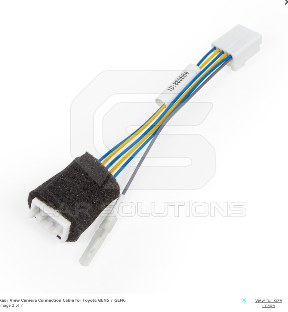

    Now this can be done without messing with OEM wires lol. Buy this kit Rear View Camera Connection Cable to Toyota GEN5 / GEN6 and this cable is the activation cable for rear view camera, just hook it up to a button that gives 6 volts i believe and it turns on the rear view camera. I found out this when i tried to add a front camera on my car with this kit lol, when i pressed the button for the front camera i had installed the rear camera appeard on the screen instead lol. [​IMG]
