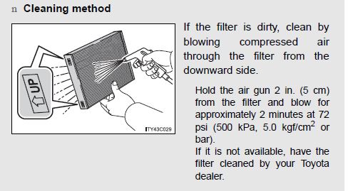

    Air compressor, meet filter.
  16. Mendel Leisk
    61,562
    42,355
    ^ That's actually in the Owners Manual, page 458. My take, clean with air once or twice, if it's not too bad, then replace the next time.
