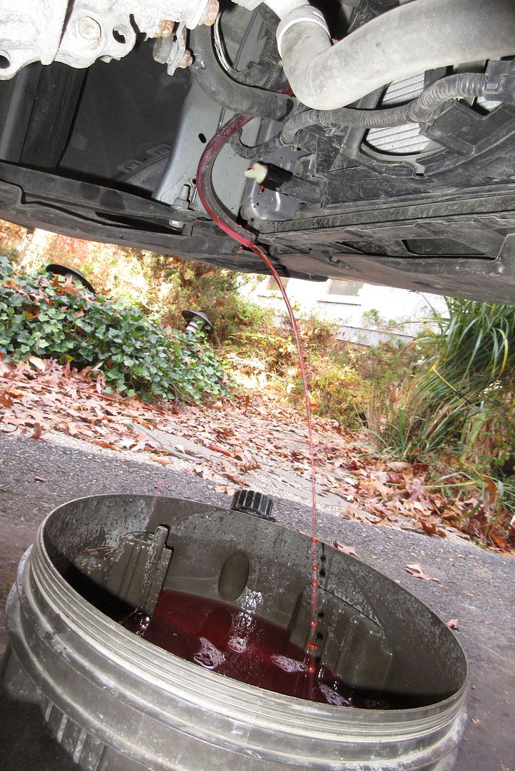

    In Gen 4, no need to flush....the two drain valves (on driver's side of radiator) drain both systems almost completely if you just let it drain for a long while (and open the radiator and caps on tanks.)
    Last year, the 2017 drain/fill took a gallon and a half of Toyota Super Long Life coolant. Specs says 6.6 Qts so sounds like I got all of it out.

    Judging from the Repair Manual, the inverter radiator is at the bottom on this gen, and drain is accomplished by opening a spigot on it.
    For both engine and inverter changes, see attachments.

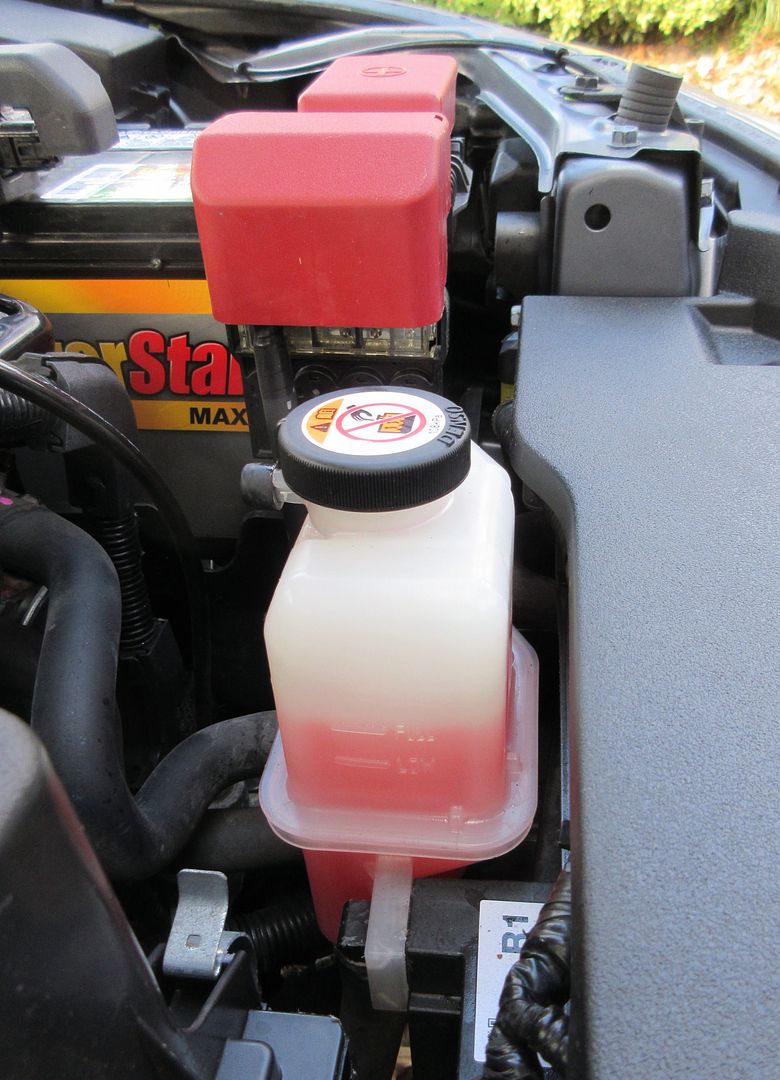

    I got the inverter drained. 29 ounces came out. Spec says 1.5 quarts or 48 ounces. Radiator next.

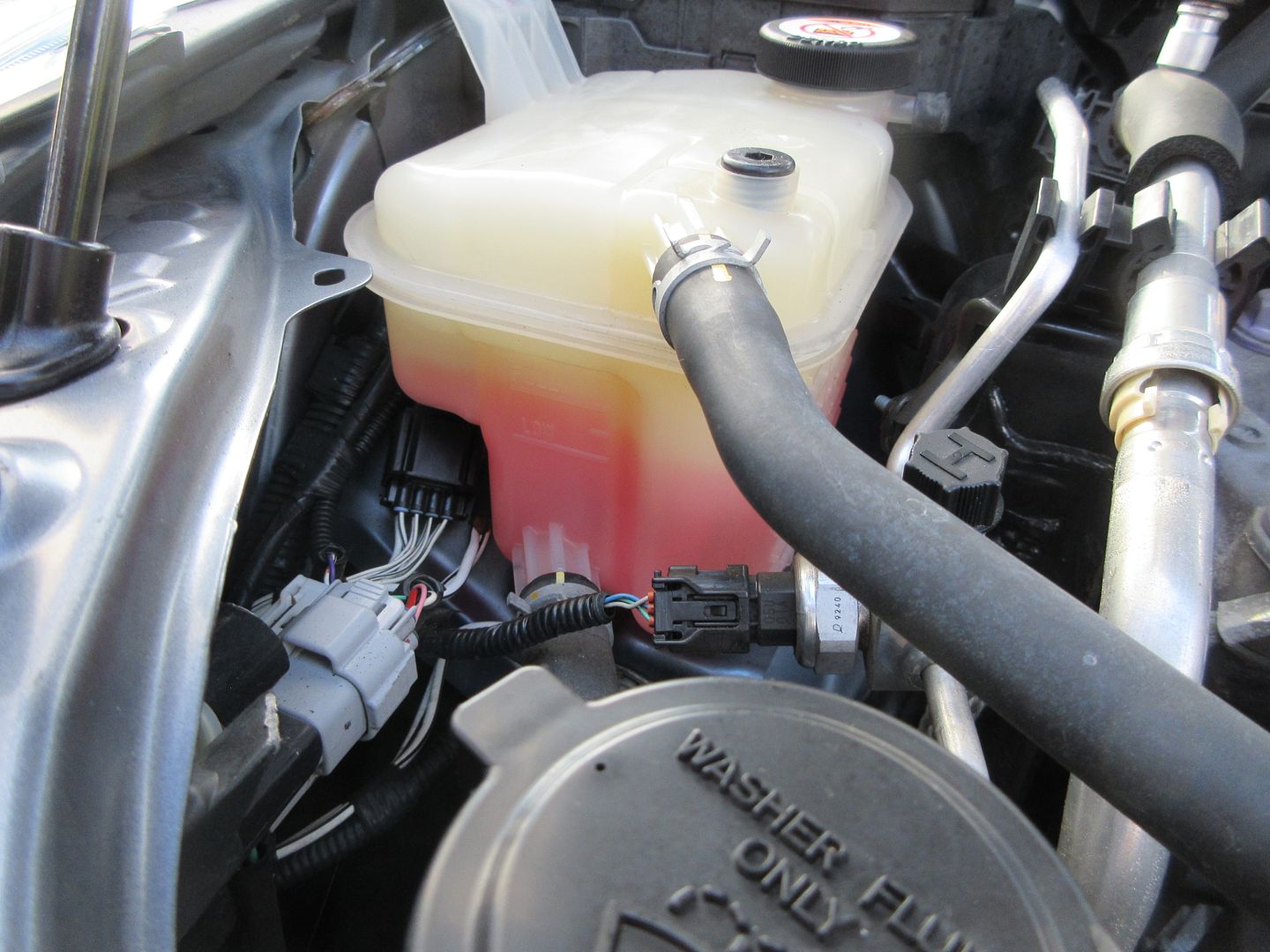

    Radiator drained out a little more than 4 quarts out of a 5.7 quart capacity. At least the old coolant looks like new so I won't feel too bad leaving that much old coolant to mix with the new.

    Inverter drained from lower valve,
    Then refill, activate inverter pump until all air comes out and pump is quiet, then top off,
    Radiator drained from upper valve,
    Then used vacuum filler to add coolant. Activated water pump for good measure then ran some errands and adjusted the level the next day,
