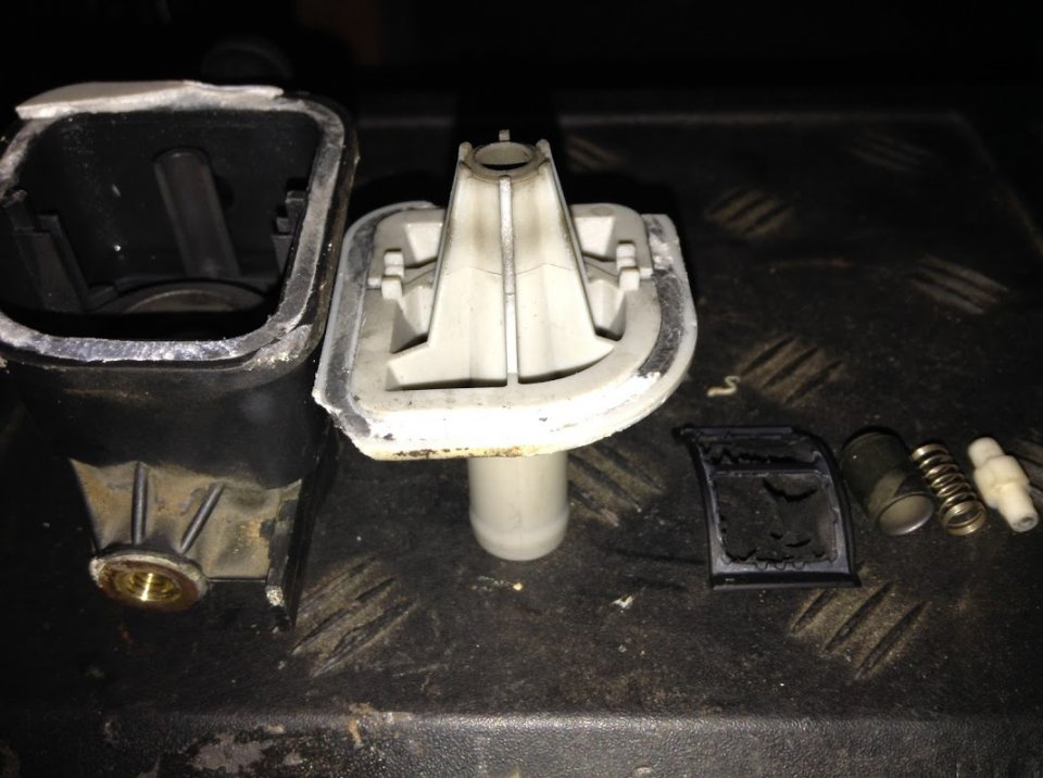

    While this thread is bumped I'd like to touch up on a couple things. I think the hoses coming off must've been caused by fuel vapors exploding, although still not sure how it ignited (only once per those two occasions; both during acceleration iirc). And I think the cause of the purge valve sticking might be due to a lack of lubrication rather than gunk build-up (because iirc mine was all dry when i cracked it open); maybe they come with some lubrication in them that dries out over time. :shrug:

    @anonymous since you're the only known member to disassemble the valve.
    Did you notice significant stiction in the assembly that would warrant using a solvent or cleaner before lubricating?
    If one were to try lubricating an assembled valve, would it be best to apply lube to both orifices, or only to the white or black ports?
    Also noticed in one of your above posted pics that the curved baffle/filter(?) may have some type of carbon build up?
    Thank you!

    No, the internals were completely dry and the slug seemed to slide easily, but I guess sometimes it gets lodged in there somehow when there's no lubricant.
    If it's installed in the vehicle then the input side (dark port) is your only option. But if you have the valve out and have a 12v power source to hold the valve open, I think it's better to drip oil down the output (light) port with it facing up so the oil drips directly on the slug. Then you can actuate it repeatedly to get the oil around it.
    Lol no, that screen is blown through! You can see it better in this image:

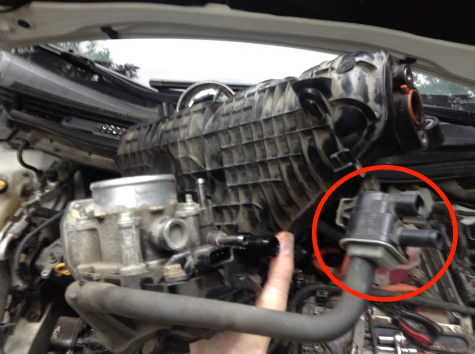

  13. Mendel Leisk
    60,299
    41,486
    Just to refresh my memory: evap purge valve is that little gizmo bolted to right side of intake manifold (as you stand at front of engine bay)? A hose runs from it to a spigot at around 6 o'clock on the round bit of intake manifold, that throttle body bolts to?

    Yes
