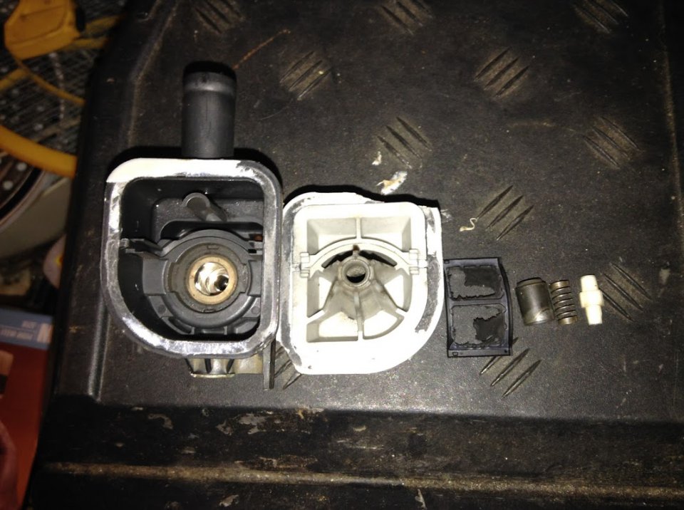

  7. Lares_Mat
    Lares_Mat Member
    May 17, 2014
    199
    59
    It looks burnt rather to me, which could be, if the filter is made out of a light plastic mesh.
    This could be a good confirmation of an occasional back fire / small explosion in the intake manifold popping different hoses off it and burning the light mesh (maybe both - blowing ang burning it) ;)
    Mat
  8. B09
    B09 New Member
    Jan 16, 2025
    Los Angeles
    thanks for sharing this. same thing was happening to my '15 prius two, replaced the EVAP purge valve and it's back to running smoothly!
