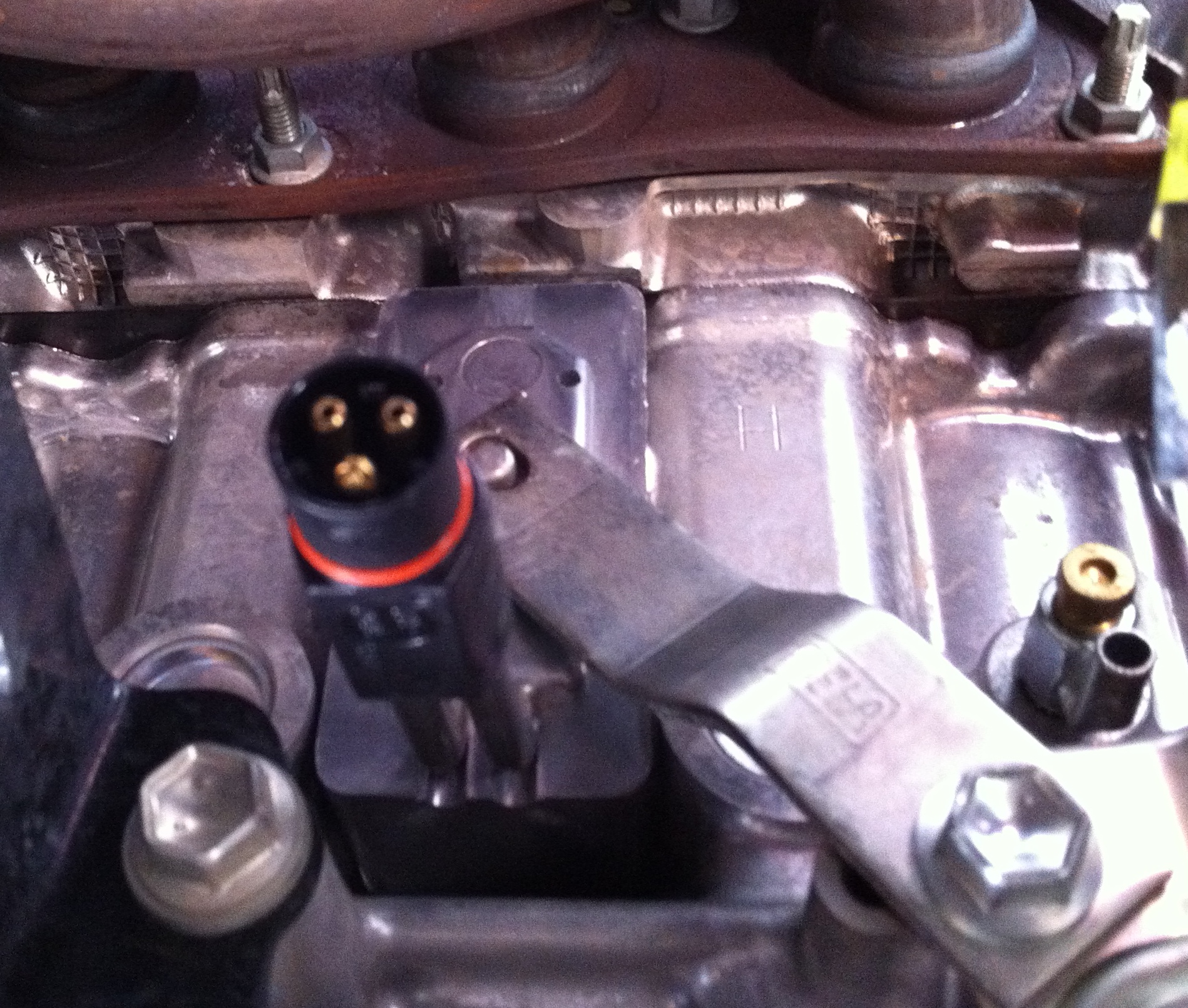

    How is the DEFA EBH attached to the engine? Pictures? Thanks!

    The DEFA EBH is clamped to the rear of the block. To visualise, [after removing the undertrays] slide under the car until your head is just behind the front wheels. Look up and you'll see the rear of the block. EBH clamps in a recess between the cylinders. So I really didn't have to dismantle anything to install the EBH, unlike the Canadian EBH!
    Routing the cable was trickier. In Europe, they must be fitted by an authorised dealer, which are everywhere. In Australia I had to figure it out and found a method that allows lower grill blocking.
    DEFA SafeStart Engine Block Heater | PriusChat
    Full stories and pix on my blog. DEFA | Bradley's Raw Data Feed

    After receiving my engine block heater today saw there were no instructions in box.
    Remembered there was an associated file on the prius shop site with the EBH location.
    The link goes nowhere.
    Not worried about the install just looking for a drawing or some general info on install.
    Anyone have that info from the shop site as a file to d'load or email?

    i put it in myself. its a bit awkward.....but possible without remove everything like that link points to.....
    the hard part is puting into block itself....couple connections just in the way slightly

    Yeah, he mentions the cowl/wiper removal was partly for photo op. The pics are from the second install, and the first was done just from the underside, cowl left in place.
    It is an eye opener though, taking off cowls. Our previous Honda Civic Hybrid was similar: cowl removal was more-or-less mandatory to even get at the back row of spark plugs (2 per cylinder). And definitely needed if you wanted to get to the valves for adjustment.
