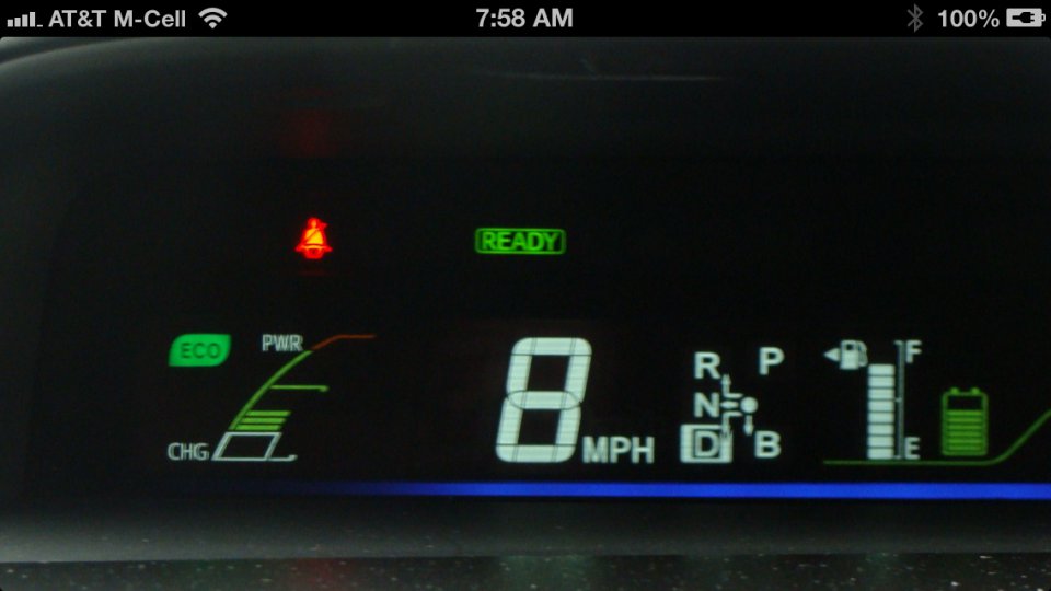

    Finally, I've tried to attach a pic of the prius v dash, where would this neutral equivalent glide be?

    On my v, two green bars is about right. It is not worth my life to study if that is precise.
