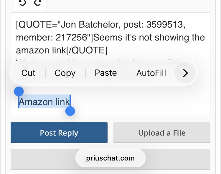

    Work around is to copy the Amazon link, then select a text string, like this:

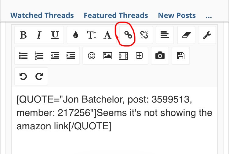

    then select this tool:
    and paste in the Amazon link.
    You can subsequently make the (still selected) text “bold” which makes it more obvious it’s a link, otherwise it’s just a subtle pale-blue tint. Finished product:
