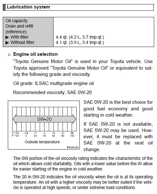

    My theory is 0w20 promotes more oil consumption vs the old school 5W30 oils.
    Furthermore, the OP's description sounds like heavy duty/high temp use that makes 0W20 an unacceptable choice:
    telmo744 likes this.

    I have to note that this plot "only" goes to 110F.
  16. Former Member 68813
    Oct 3, 2010
    3,524
    983
    US
    Did you read the text?
