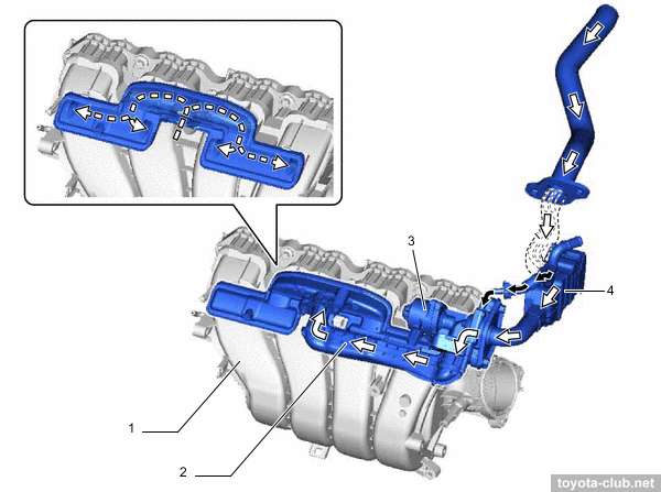

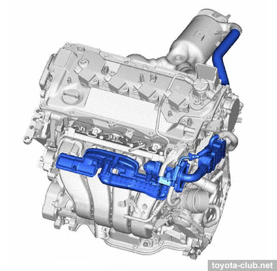

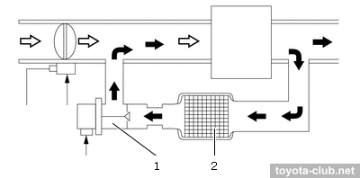

    EGR (exhaust gas recirculation) - inevitable evil, which serves (in theory) to lower the combustion temperature and to reduce the nitrogen oxides in the exhaust gas, but in practice it provides only common problems with carbon deposits in the intake paths and on the valves. Soon let's see whether it is possible to shut off it without consequences (at least, there is no feedback by EGR temperature sensor here).
    1 - EGR valve, 2 - EGR cooler
    The gases taken out downstream the catalyst pass through the channel in the cylinder head to the cooler and then to the valve. The EGR valve (also water-cooled) is driven by a stepper motor.
    Then the gases flow to the EGR manifold, which evenly delivers gases into each cylinder.
    1 - intake manifold, 2 - EGR pipe, 3 - EGR valve, 4 - EGR cooler
    So it looks like the new solution is:
    Post cat egr (cleaner), larger and smoother intake egr passages, and a larger central position entry into the egr passages in the intake manifold now to get more even flow from shorter more balanced passages.
    Big benefit over the old ones where pre cat egr and entry on the far side of the intake manifold resulted in quicker clogging and more uneven clogging to the far ports. The results will probably be the car will probably clog the egr far far slower than the gen 3's, hopefully after the usable life of the car is finished.
