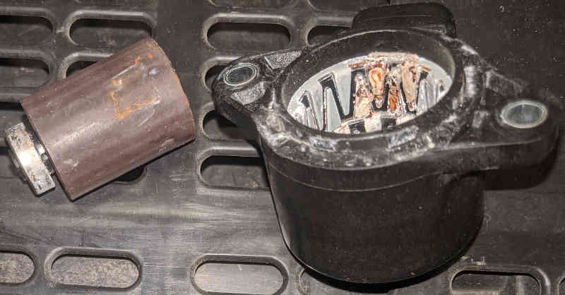

  19. Willy Toast

  20. ChapmanF
    28,744
    19,045
    It did when I was done with it. :) This was a valve I bought from somebody else as a spare, and I suspect it had been in storage and hadn't been operated for a while. The corrosion on the stator poles was fairly superficial, and I just made sure to clean it off, as well as the matching rust marks on the rotor, so there would be no mechanical interference between the two. I think I used a bit of Nevr-Dull on the stator, not for the aesthetics, but because it leaves a bit of residue behind that should slow further corrosion.
    It's convenient that when reassembling the valve, it's hard to keep the rotor spun all the way down on the stem, against the spring; one has to let go eventually before the stator is all the way back on, and the rotor rides a little ways up on the stem. Then cinching the stator down pushes on the rotor and opens the valve slightly.
    That makes it easy to check that the valve pintle can be pushed back to a fully closed position easily with a thumb. It moves smoothly back, with a soft whirring sound, confirming that the rotor is spinning inside.
