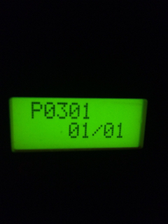

  7. chrisasst
    chrisasst Junior Member
    Jan 22, 2014
    29
    Cortland, New York
    Ok I get the misfire in one code
    I drove it and still has the same ol' power. Don't feel any misfire. Could slamming the breaks make it misfire and get code?
    I reset the code. Drove it a few miles and rechecked and no code came back. Would it take a 100 miles or so for the view to come back if it was a problem?
    I know I had this code on my Hyundai last winter and it went away. Should I just wait to see if it comes back?

  8. bisco
    115,361
    52,804
    try disconnect the 12v for a few minutes.
  9. fuzzy1
    17,900
    10,690
    I had this on a previous car several times. First time (no code reader), my preferred mechanic expressed no concern unless it returned. It cropped up a couple times again, years later in cold and wet weather, when I had a code reader. Cleared it, returned once again a few days later, then never again.
    If it was a continuing problem, it would reappear immediately. Just wait for it to come back.
    Don't bother. If the light is currently out, then no need.
  10. johnnyb588
    johnnyb588 Member
    Dec 19, 2014
    193
    73
    Tempe, AZ
    I
    +1 to fuzzy's suggestion. Wait for it to come back (if it ever does), then go from there. A hard stop causing a misfire is a new one to me.
