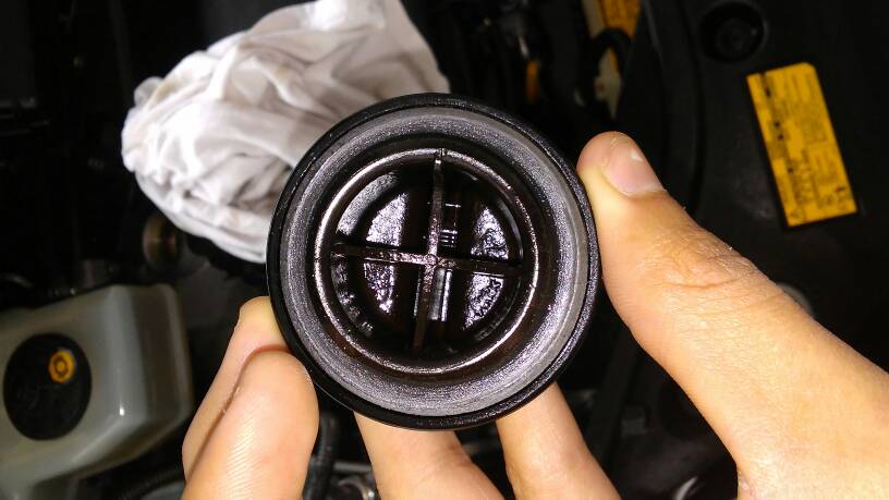

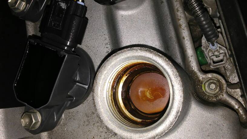

    Hello everyone,
    My gf recently bought a used 2008 prius with 100,000 miles. It runs fine but i have a few questions.
    The engine oil cap has some brown smudge on it. If i look inside it is also brown. Is this normal? It also had some steam coming out (just a little) here are some pics. [​IMG][​IMG]
    I checked the engine coolant (gas engine coolant) and it is pink. The electric engine coolant is also pink. Is this normal? Thank you

    Bought look normal. Prius (gen 2 (2004) and after) uses Toyota super long life coolant (SLLC for short) (which is Pink) for bought cooling systems.
    Check for that all routine maintenance is done. Keep your eye on oil level (some Priuses burn a bit of oil). Change the transmission fluid if not done (no for flushing). Clean the hybrid battery fan.

    Probably dealer serviced with vat oil. Go to Walmart buy 5 quart jug of 10-30 Mobil 1 for $23. And dealer oil filter for $4. Get that oil changed, with new filter it takes exactly 3.5 quarts.
    Go to Toyota.com/owners and join there online forum. Enter the cars vin.
    You will see every time the car has been serviced at any authorized Toyota dealer.
    It will give you a sense of how the well or how little the car has been serviced.
    Btw you can use it as your own service log too as you can enter your own data to it,
    The dealer monitors it. Every time I enter personal service on that site I get a robo call from the dealer with service requests. And then I get coupons in the mail. C'mon down let us swing at your car at $140 an hour all afternoon

    Oh and no matter what u think it looks like change the water pump belt in the front if the engine. It's easy if your handy. It's only job is to turn the engine water pump. Belt breaks no water flow in engine engine overheats blows head gasket. NO temp gauge you'll never know it's overheating till check engine light comes on and by then motor damaged.
    Bad design. Easily mitigated by $10 belt.
