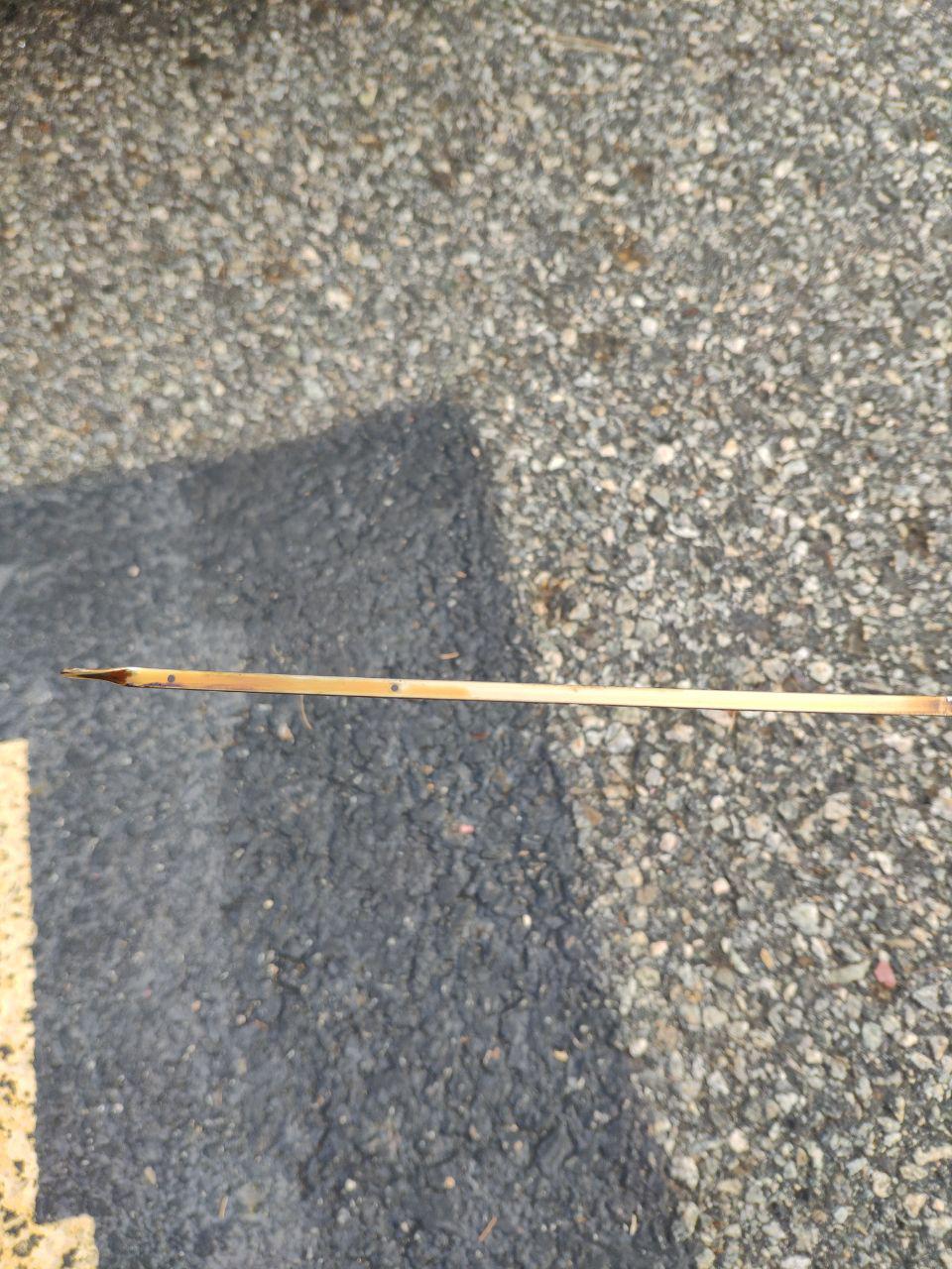

  6. msg7086
    msg7086 Member
    Sep 29, 2013
    39
    38
    North Jersey
    What do you think? (Measured @ cold and dark.)

  8. Stevewoods
    Stevewoods Senior Member
    Jun 10, 2014
    667
    1,268
    where I am
    What does the other side look like? Sometimes, both sides of the stick are at the same level. But for MY Prius, it always seems that one side of the stick is at one level and the other side is at a different level.
    Rule of thumb is you go by the lowest level. If the picture represents the lowest level and it was measured after the car has sat for at least five minutes (personally, I only measure after it sits overnight), then it is overfilled. But not horrible. I would not worry about it, but then it is not my car. Your mileage may vary, your oil level may vary. My advice is worth what you paid me for it.
    In other words, it is your car and your decision. Just because I wouldn't worry doesn't mean I am right.
    The following information is available all over the internet and most mechanics say the same thing these guys do, but I like Tom and Ray, so I will post their link -- by the way -- I agree with previous sentiments about your stress level on this issue. Life is short. Relax.
    Blog Post | Could overfilling with oil damage my engine? | Car Talk
    Merkey and Raytheeagle like this.
  9. msg7086
    msg7086 Member
    Sep 29, 2013
    39
    38
    North Jersey
    Thanks, Steve. I don't know maybe it's language barrier, but I'm not stressed on this issue. To me, if there's a chance I can improve it, and if it won't cost much, I'd choose the better way. Otherwise, I'd leave it as is.
    I'm new on car maintenance, and I don't have anyone around to ask (my parents are at the other side of the earth), thus I'd like to read, to ask, to learn, and then to share.
    The oil level is measured at "cold and dark" condition (sitting still overnight), and both side says the same. I'm not worrying about it damaging anything, but would like to hear opinions from you. You know, if they overfilled it, on my next visit I can probably point out. Or if they overfill it on purpose to prevent oil burning. Or other fluid leaks into oil, etc.
    I appreciate all the inputs. I learned a lot from you.
  10. Mendel Leisk
    61,557
    42,355
    The difference between top and bottom marks is (roughly) 1.5 quarts; that's maybe a pint overfill.
  11. Patrick Wong
    Patrick Wong DIY Enthusiast
    Mar 8, 2008
    18,210
    6,526
    Green Valley, AZ
    Since you say that both sides read the same, I would suggest draining out around a pint of oil.
  12. edthefox5
    edthefox5 Senior Member
    Jul 25, 2007
    10,096
    4,840
    Clearwater, Florida
    The dipstick looks about a 1/2 quart overfilled. That's a classic dealer oil change using a pneumatic pump which is notoriously inaccurate to pump out crappy tank oil. They always pump in some more to make sure its not under filled. The worst possible oil you can put in your car.
    Lots of cars on this site with overfilled dealer oil changes. Some it stalled out the engine down the street.
    Synthetic oil is 100% better in all regards to dino oil.
    Go to Walmart buy a jug of Mobil 1 5-30 100% synthetic for $25. Jug is 5 quarts.
    My bought new 07 has had its oil changed about 26 times so far. By me. With a new filter it takes 3.6 quarts. If I need the oil changed and don't feel like doing it I take it to the Jiffy down the road. I give them exactly 3.6 quarts of oil either by draining out 1.4 quarts out of the M1 jug or filling up 4 quart bottles. That way they cannot under any circumstances f it up. I stand there and watch them and wave them off everything but the oil change. With a coupon the labor is $20. Takes 10 minutes.
    I have about 140,000 miles on my car. It started to eat oil very slightly at around 120,000 miles so I moved up to a 40 weight oil. last 60,000 miles I moved to Redline Oil 5-30 which tends to turn into a 40 weight oil at temp. It also has a good ZDDP package which really quiets down the solid lifter motor. It stopped my oil loss completely. Very high performance oil. Engine runs really well on it.
    if your car is eating oil move up to a 5-40 weight oil. keep it at the top mark on the dipstick always.
