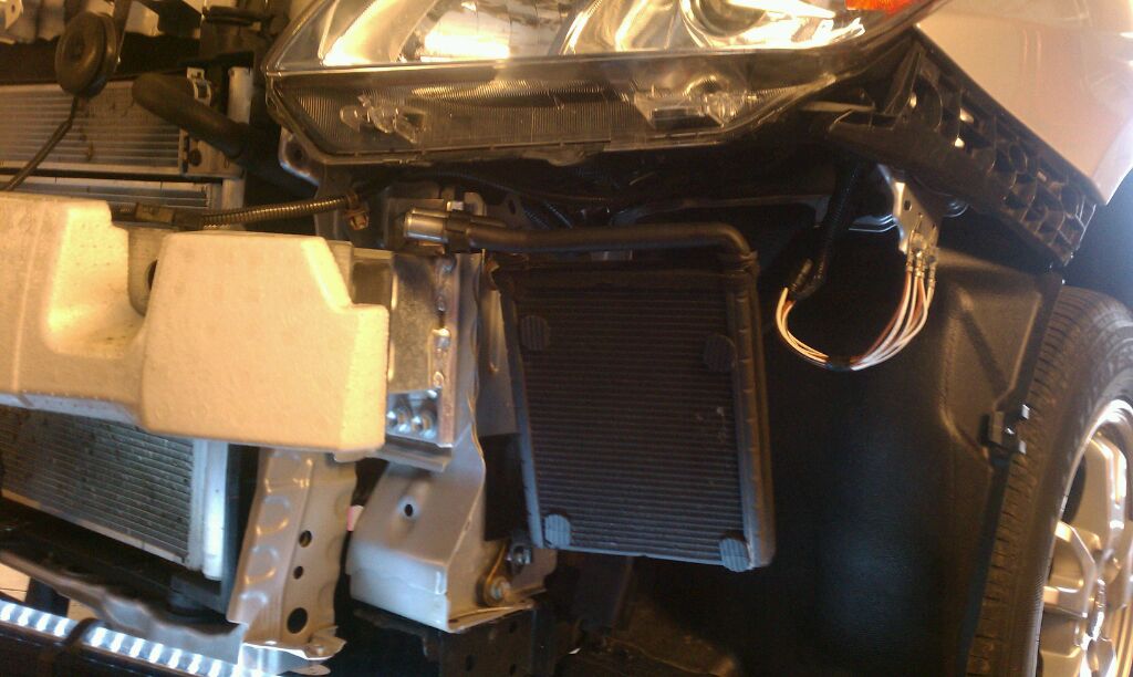

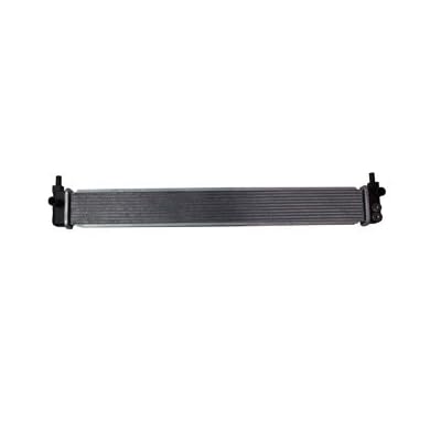

    And I intend to add another inverter cooler to my '15. That one^^^^ worked fair at best. Didn't achieve the results I wanted. It needed it's own fan. A motorcycle fan mounted to it would've been perfect and may be what I do next time. Or I may add a 1st gen HV radiator as I did on my 2nd gen car. Things get quite warm when you autox.

    In my case, heat soak between runs is an issue. You make a run, 45-60 seconds, then you sit while the other cars in your class make their runs. Then back to you, typically get 3 or 4 runs. To top off the HV battery between runs I force charge, which builds heat in the HV system. Also, the many times at WOT on course also builds heat in the system. The ICE stays relatively cool but I've seen inverter temps above 130 degrees and climbing between runs. I run the HV fan on high but minus a bag of ice on the inverter (yep done it) I haven't found an effective way to keep inverter temps noticeably cooler. The unit I used in the picture in one of the earlier posts was just a heater core from a Corolla plumbed after the OEM inverter radiator.

    That's an AWESOME price. That would be large enough in addition to the original that it should dissipate heat well without an additional fan.
