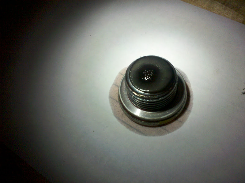

    The factory ATF WS came out with a red hue, not solid black like I expected. The fill plug came off with ease. I thought I would have to get a breaker bar for the drain plug, but I got it off. The crap on the magnet was like a very fine black paste, almost like grease.
    BEFORE:
    AFTER:

    Good photos Aaron. My experience was almost exactly the same as yours. Mine also was not not fully black and actually looked a little better than I expected for 62000 miles. In addition my drain plug looked pretty much the same as well. Yes the "paste" is extremely fine. I had expected it to feel almost "gritty" but in fact when I scrapped it off it felt almost exactly like grease. Like if someone had have handed me some on the end of a screwdriver and told my it was molybdenum grease I probably would have believed them. :)
    Here are my pictures.

    Yeah mine at ~40K wasn't too bad, still plenty pink. Plug looked about the same.
    How much new fluid went in for you Aaron?
