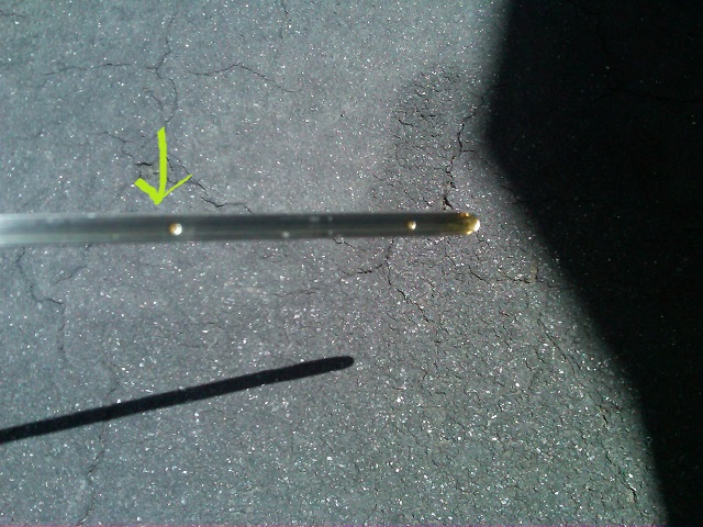

    Sorry for the blurry pic, I have no patience trying to take a sharp steady picture with oil dripping. But anyway, here is the pic with brand new oil. I just had it changed at 20k miles. It's pretty clear compared to before and even tougher to discern the level but not impossible. I decided to go to the dealer near my work instead of near my home to compare. As you can see by the yellow dot on the full mark and obviously by my arrow, the other dealer yet again overfilled. But it was less than before. The trip to and from dealer was entirely on EV so the ICE had been off for 5 hours. I'm at a loss to why dealers would do this. It costs them money to give us more oil.

    It's a bit hard to tell with the out-of-focus pic, but the level might be spot-on:
    Notice the lighter coloured patch, just below and to right of the full dimple? That might be the level. The dipstick tends to smear way up, along the edges, but if you look closer you'll see a bare patch lower down, the actual level.

    I'm not a mechanic but I've seen my fair share of dipsticks. The level is as I stated with multiple checks. I'm definitely not a professional photographer, though.

    i'm 90% convinced i can read the level on my dipstick.:confused:
