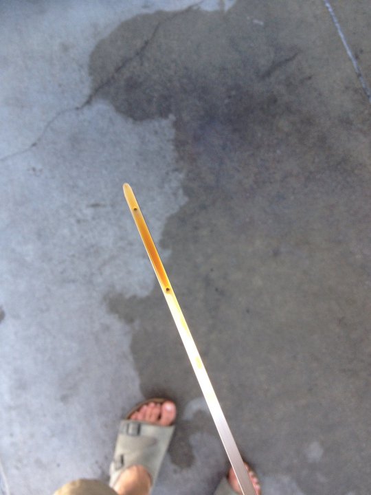

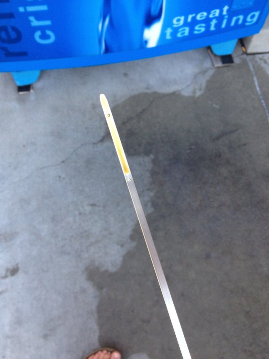

    So after reading this discussion, I decided to check what the factory level was, since I'm still under 10k miles.
    mmmodem likes this.
  20. bisco
    115,445
    52,854
    right at the top dot, perfect! a lot easier to read than fresh stuff. i can't even see streaking above the dot.o_O
