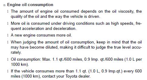

  15. Mendel Leisk
    61,572
    42,361
    It's in the Owners Manual, page 428:
    Pretty pathetic, but hey.
  16. bisco
    115,498
    52,878
    so, on a 10,000 mile oil change that's how many quarts?:eek:o_O:p
  17. Mendel Leisk
    61,572
    42,361
    C'mon, look on the bright side: if you're consuming a quart every 600 miles, you don't need to change the oil. :whistle:
