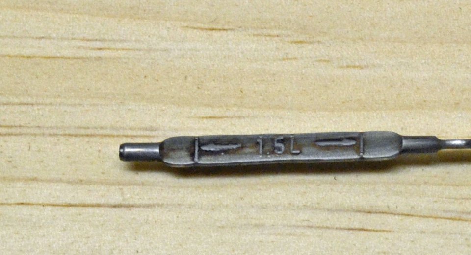

    "I think the much more important lesson to learn is that these Alu engines do not tolerate abuse and do not have much oil reserve." That was my observation. My daily driver has a 2.5L engine, 6.2qt oil capacity and there's 1.5L between full and add on the dipstick. I maintain my cars well so this doesn't matter to me, but it does help the neglecter.
    Robert Holt likes this.
  8. Mendel Leisk
    61,572
    42,361
    ^ That's a nice idea: a dipstick indicating range.
