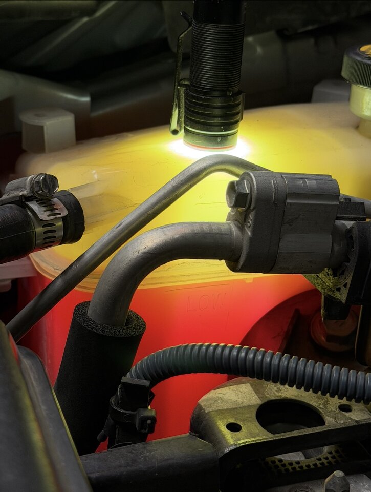

    Pressurizing a full cooling system would be a good first step. Check for pressure drops and leaks. Then I would monitor coolant temperature with a scanner and warm up the engine to 200f. Check for reservoir flow. The temperature should not exceed 220f in a normal engine.
    Coolant release from reservoir cap
    When fully warmed up, thermostat opens allowing water pump flow to be observed from top hose with light

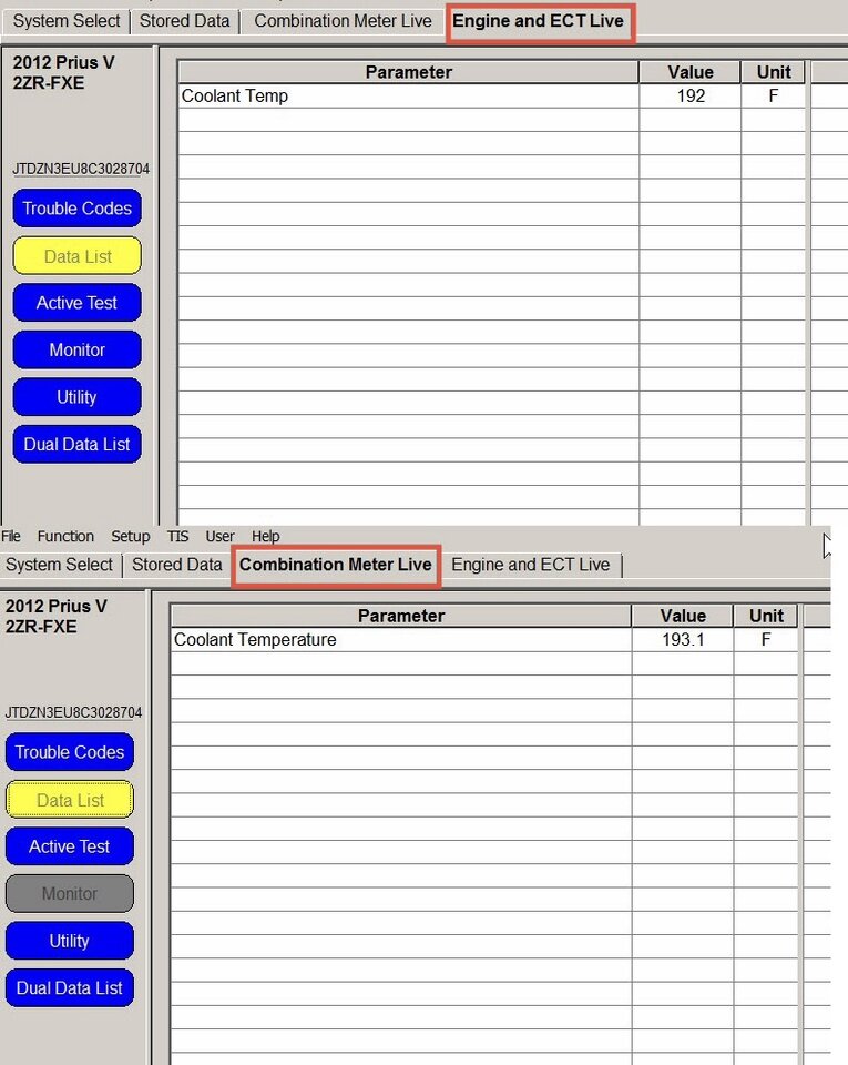

    The first thing I would do to diagnose the engine overheating problem is to use a scanner that is capable of looking at live data. I would look at the actual water pump speed (RPM) versus the requested water pump speed. This will tell you if the water pump is working correctly. The water pump may be working correctly at engine idle, but it may not be working correctly once the coolant warms up while driving on the highway.
    If you do not have a scanner that can look at live data, then I would use a scanner to monitor the engine coolant temperature (ECT) while driving the car. Normal coolant temperature while driving on the highway is 195F. The temperature normally will not go above 202F.
