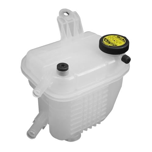

    - I've replaced the engine coolant reservoir with the one that has a bleeding hex bolt some of the gen4s don't have bleeder valve on coolant reservoir.
